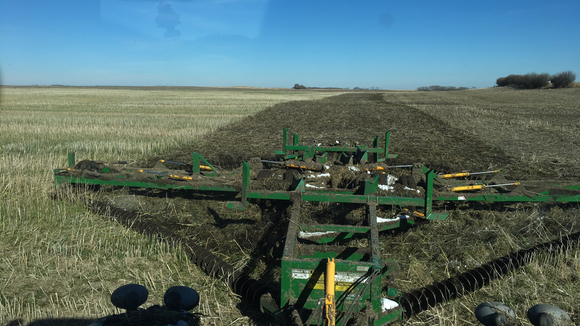

    have not tried any of the new tillage systems yet , what are people's thoughts on which ones work the best? we have ruts all over a foot deep , heavy straw on high spots , some uncombined straw in low spots, and water all over . is there any system that will help all of these ? hoping some of the water will be gone by spring . watched a video on degelman pro till , looked interesting , but like I said , have no experience with any of them ? scic $100/ac too wet to seed looking pretty probable right now. probably had 8-10" of moisture out of snow and rain so far in oct , fields are sliding into creeks and rivers all over , haven't saw the sun in October, no one has ever saw anything like it here, ever ....

    Sounds like you need a good old offset disk

        My Kelley disc is a good all round machine! I'm still going but my days are counting down!

          Does it fill deep ruts ,what kind pf ptice are they ?

                If you can get your hands on a case turbo till 330 or 335 it will work very well in mud and ruts . Also leaves a very good field finish that you can seed into .
                If you have rocks , the Kelly harrow will be better .

                  I heard the "rolling baskets" of the vertical tillage tools can fill with mud in wet conditions....Degelman Protill has the corrugated rubber drum packer option. Which option do you have bucket?
