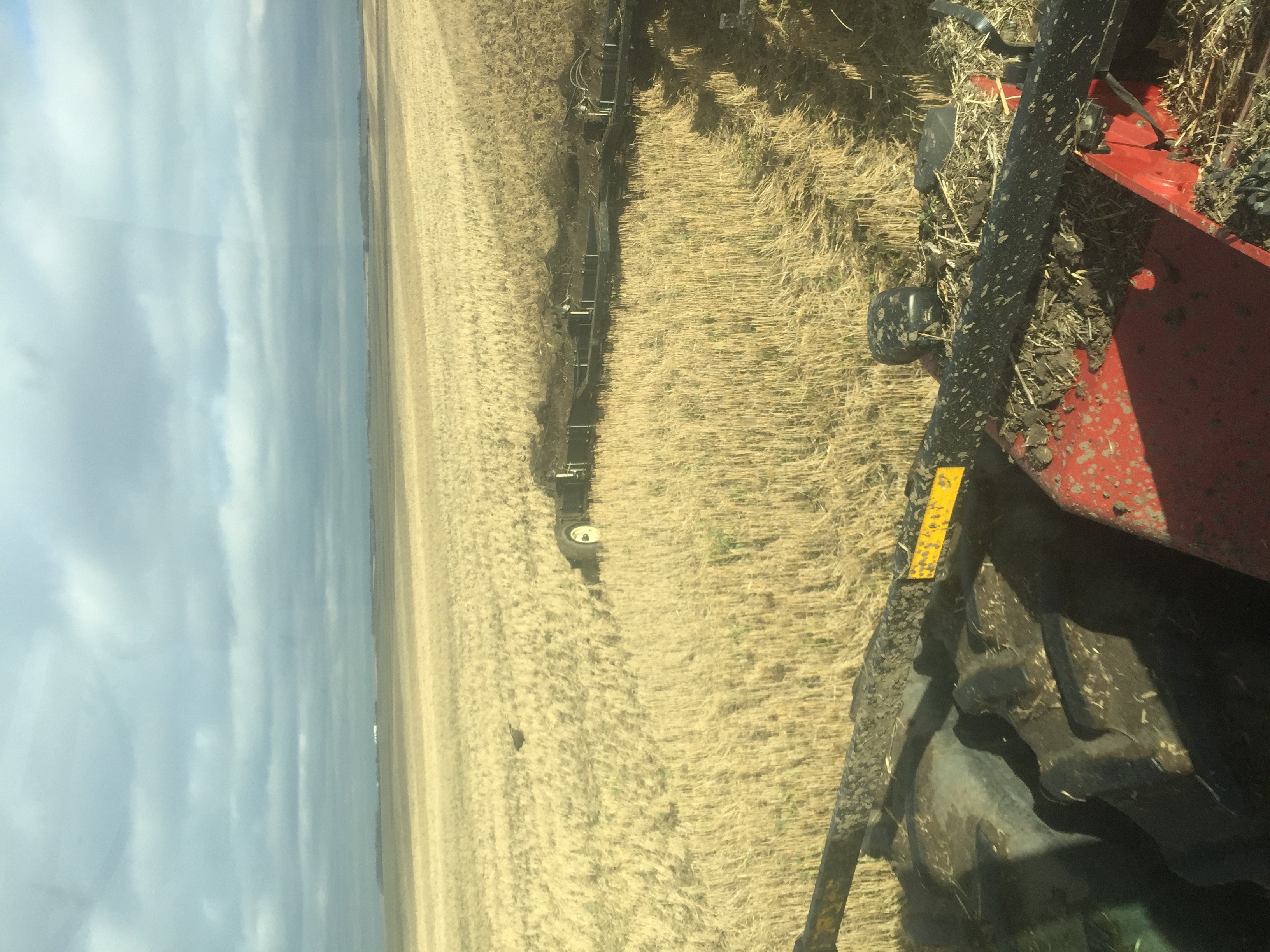

                  • 22490
                  This is the gates coulter harrow on SWW stubble

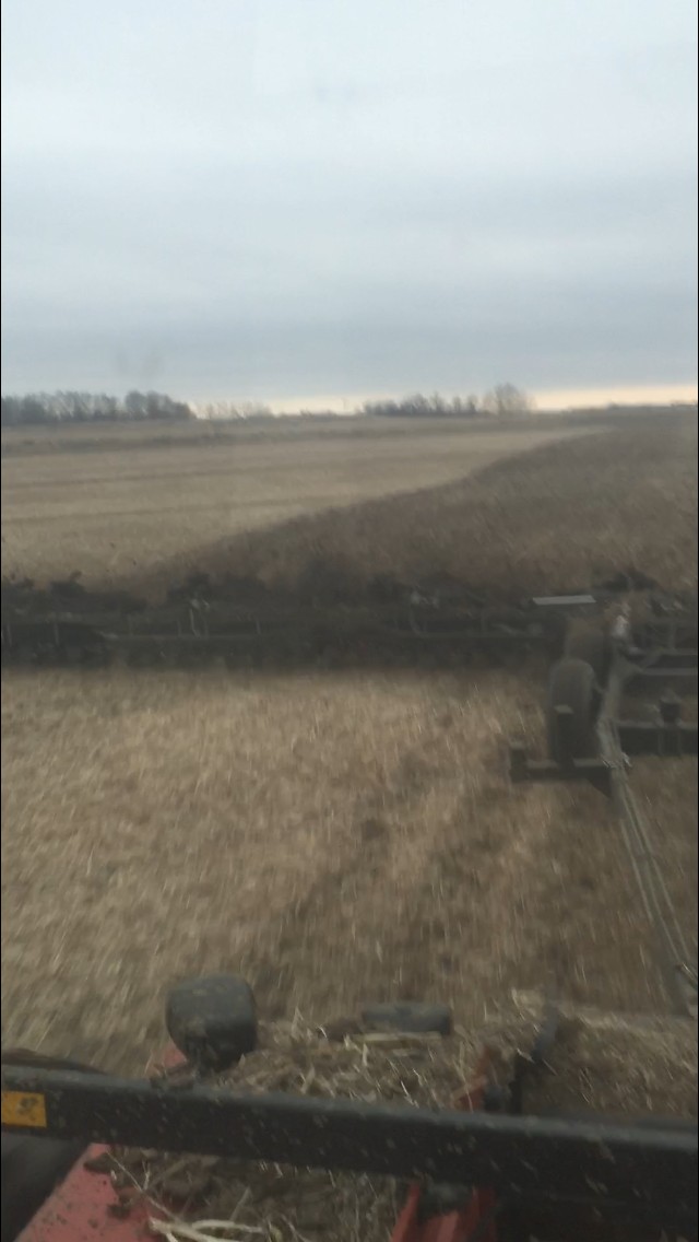

                    • 22490
                    Canola stubble

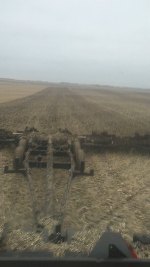

                    Soybean stubble
                    Both days , well all days have been cloudy and misty , ground is wet but not mud in those days .
