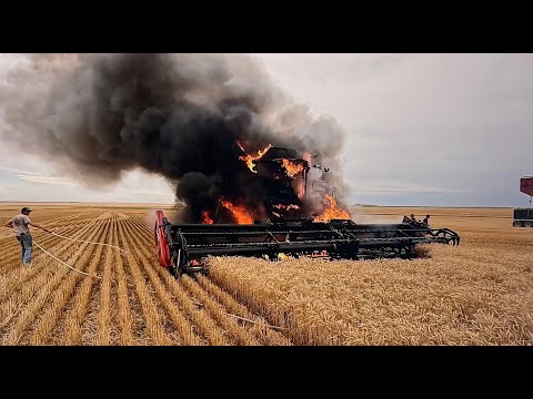

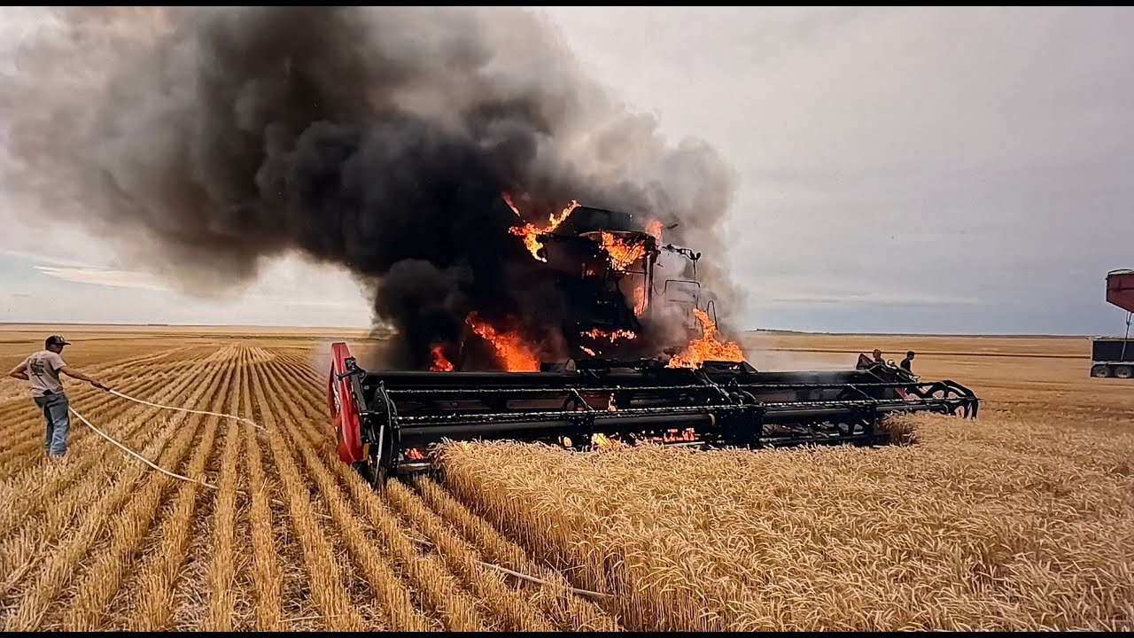

    What started as a routine wheat harvest turned into chaos when a Case IH combine suddenly caught fire in the middle of the field. Watch the frantic scramble to put out the flames and stop the blaze from spreading through the dry crop. A gripping reminder of just how fast harvest can go from smooth to dangerous.

    Essentially you are wasting water on the machine. Fire control spent on spreading prevention. Once the fire was noticed the operators had barely time to hit the ground before flames over grain tank.
    1100 litres diesel in a plastic tank.
