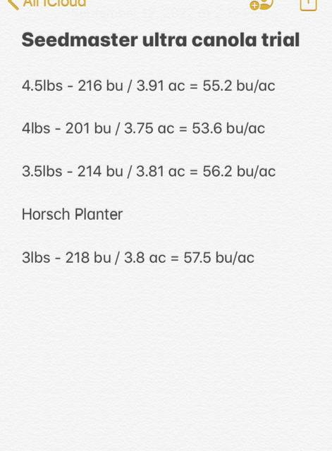

          • 22650
          Canola seed rate trial
          Seed size was 6.8 TKW
            Impressive yields furrow !
            Nothin that high in the swamp
            Thanks for the info
              • 22650
              That field caught some of the big rain closer to NB , 2 in more than home only 3 miles away . 7-10 bus better.
              It went into dry spell with 7.5 in rain
              Closer to home was about 5.5 -6

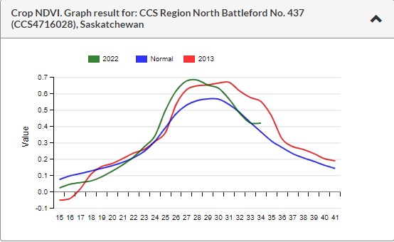

              • LWeber
                • Nov 2007
                • 1438
Name:	Screenshot 2022-09-13 113003.jpg
                  • 22650
                  I would think RM Meota graph hung in there a little longer ?
                  Makes sense we tailed off fairly quickly
