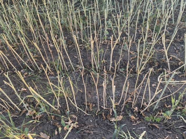

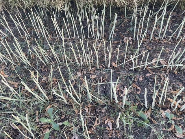

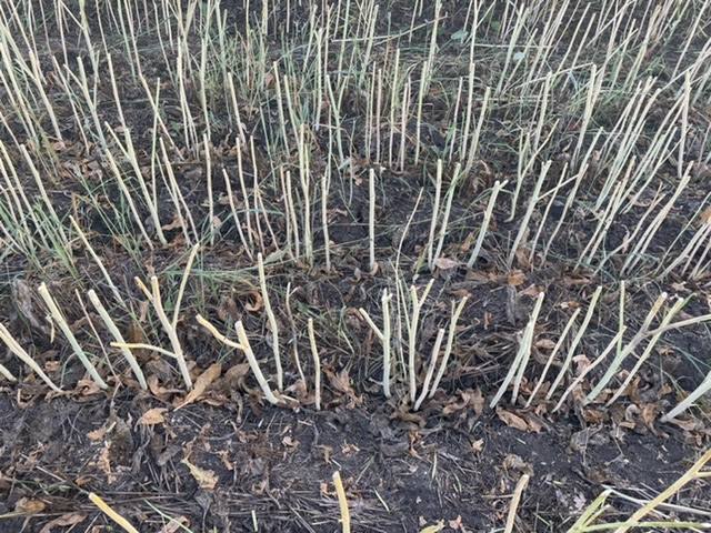

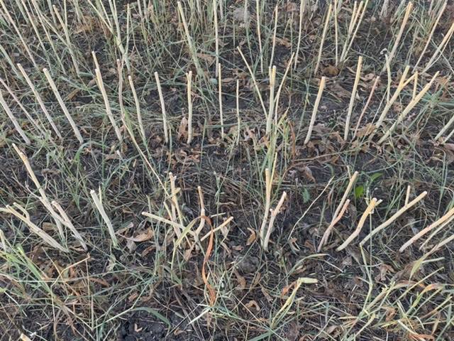

      Canola trial , Horsch and SM SR
      Horsch at 2.2 lbs
      Seed Master at 3.5 lbs
        • 22650
        Seed Master at 4 lbs
        Seed Mater at 4.5 lbs
        As seeding rate goes up , stalks get smaller . That’s normal
        Wish we did a 3 and 2.5 with SM SR now but thought the seed was too big for that low of rate without a planter . Seed size was 6.7 TKW
          • 4071
          Furrow the Seedmaster 15 inch looks pretty good, yields will be interesting to see on the wheat.
          The germ on the canola looks pretty good on the Seedmaster as well. The biggest advantage I see with the Seedmaster over the Horsch is one pass vs two. Thanks for the pictures.

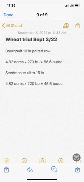

                  Just doing the side by side with bourgault and Seedmaster in wheat
                  12 in paired row to 15 in single
                    • 22650
                    Should read 12 in paired row for bourgault
                    This was very dry field
                    • flea beetle
                      • Jun 2019
                      • 1287
                      Was this hard red or cps? Very good info! Have had a 10” paired row flexicoil 5000 for quite a few years, and bought a seedhawk 12” space with single row openers. Debating putting paired row on. Looks like it will pay to do so.
