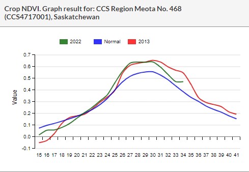

    I would think RM Meota graph hung in there a little longer ?
    Makes sense we tailed off fairly quickly
Name:	Screenshot 2022-09-13 115248 MEOTA.jpg
    • LWeber
      • Nov 2007
      • 1438
      [ATTACH]11056[/ATTACH]
      Meota RM came in at 51.45 bpa on Aug 27
        • 22650
        Awesome info Larry
        Thank you 👍

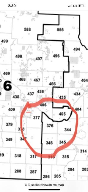

          • 22650
          And these RM’s just SE of here will be 20 bpa max
          That area been drought stricken 3 years straight

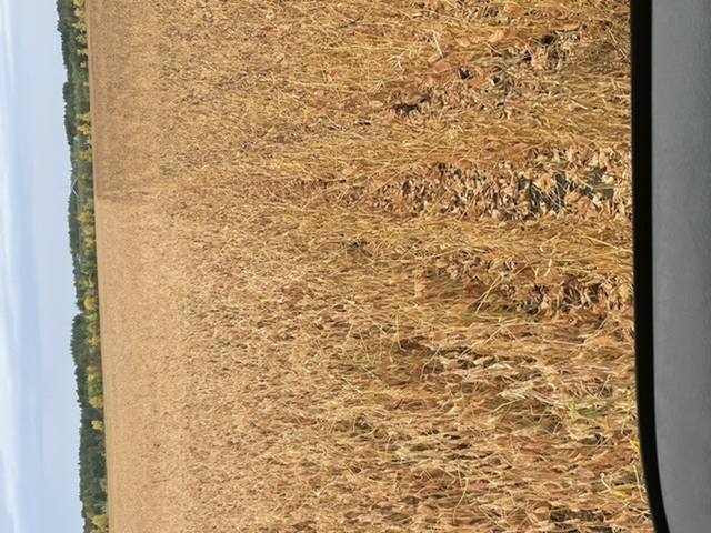

                  • 5442
                  It’s in a plot with 8 varieties, all RR . All seeded the same time, same fertility, same everything
                  The variety on the left had a ton of cracks in it , seed treatment was dusty and seed size was variable. The one on the right was nice even big seed . In dry cold conditions, seed quality is huge
                  This was seeded around the 20th so not “early” but we had cold dry frosts from May 31 to June 3
                  This stuff was just up and seemed not affected.
                  The balance of the field looks good . Just this one variety that had very questionable looking seed when we opened the bag .
                  Did you get any results from this situation with the different seed quality?
                  I may have missed it.
                  Thanks for all the work and data sharing.
                  Always inaresting.
                    • 22650
                    Always inaresting.
                    That variety was 5 bus less on average of the others . Did surprisingly well considering how it looked . In other trials in area with not the seed issues it was top 2-3 in every trial
                    Good seed matters .
