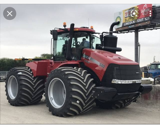

    Our next update will be these ...
    From most data I have seen a properly weighted tractor with 1400’s will pull as good or better than tracks , way less maintenance, cost between regular tires and tracks . Superior ride over both in field and road ... they say .
    Unless you have big hills , then tracks probably slightly better .
    We have a 535 with triples and it pulls very well and goes through a lot if need be .
    But it is very wide and can be a rough ride on coulter harrows at 12 - 14 mph.

      We have big hills and the quad tracks win hands down over duals or triples. Twin tracks pull good going straight but are done when you try turning. Used quads will get a little harder to get because the big guys are switching to the big singles like Furrow said. And we still refuse anything with Goodyear tires.

        Thanks furrow, can only imagine what replacing a 1400 tire would cost. Maybe you can upgrade from your versatile to one of those and then sell me your versatile 😜
        I would like the tracks for how narrow they are compared to triples. Tracks do demand a premium compared to tires. Don’t see too many triples and probably won’t be going much faster than 8-10 in the field. Triple might be a pain on a grain cart also.

          That Versy will be the one we put the big singles on when the time comes .
          Will probably get a longer life from the 1400’s then a set of tracks and have near zero maintenance if keeping for a long time as we generally will do with tractors
          The ole 9270 we bought new is over 12,000 hours now

            wow those are quite the tires, wonder what kinda air pressure they would run? Kinda wonder if they would bounce or power hop worse? Better in the mud I bet.

              We have tracks and tires.. if you have hills go the track route but be prepared for the higher cost upfront and maintenance costs.
              Our most recent tractor we chose to put on 800 LSW’s and they seem decent. They are an improvement over the old 800r38’s. I like that I don’t have to worry about idler bearings, alignment issues and defacing boggie wheels.

                When pulling heavy loads on loose soil the 1400 Lsw’s don’t perform like the tracks. Dealer told me of instances where tires come off the bead on the rim when trying to get max power to the ground. Trials were done on caseih 620. Nice for road travel but prefer the tractor to perform to its potential in the field.
                Have put 7000 hrs on one set of tracks with minimal expense. Bogy wheel seals fail at times but new improved seal eliminated the problem. We run 3 620s and 1 600 and all have been rock solid. High speed work on the grain cart is probably biggest detriment

                  If you can afford the up front costs , tracks are great , but for an all around slightly more affordable unit for seeding , higher speed harrowing , pro till or grain cart I like the idea of the 1400’s . But I have no experience with them , just think more from an affordable angle than tracks .

                    Shed antlers are the big tire nemesis. Can happen when they are brand new.
                    If there is somewhere that can vulcanize repairs it whould be good to know before you need them.
