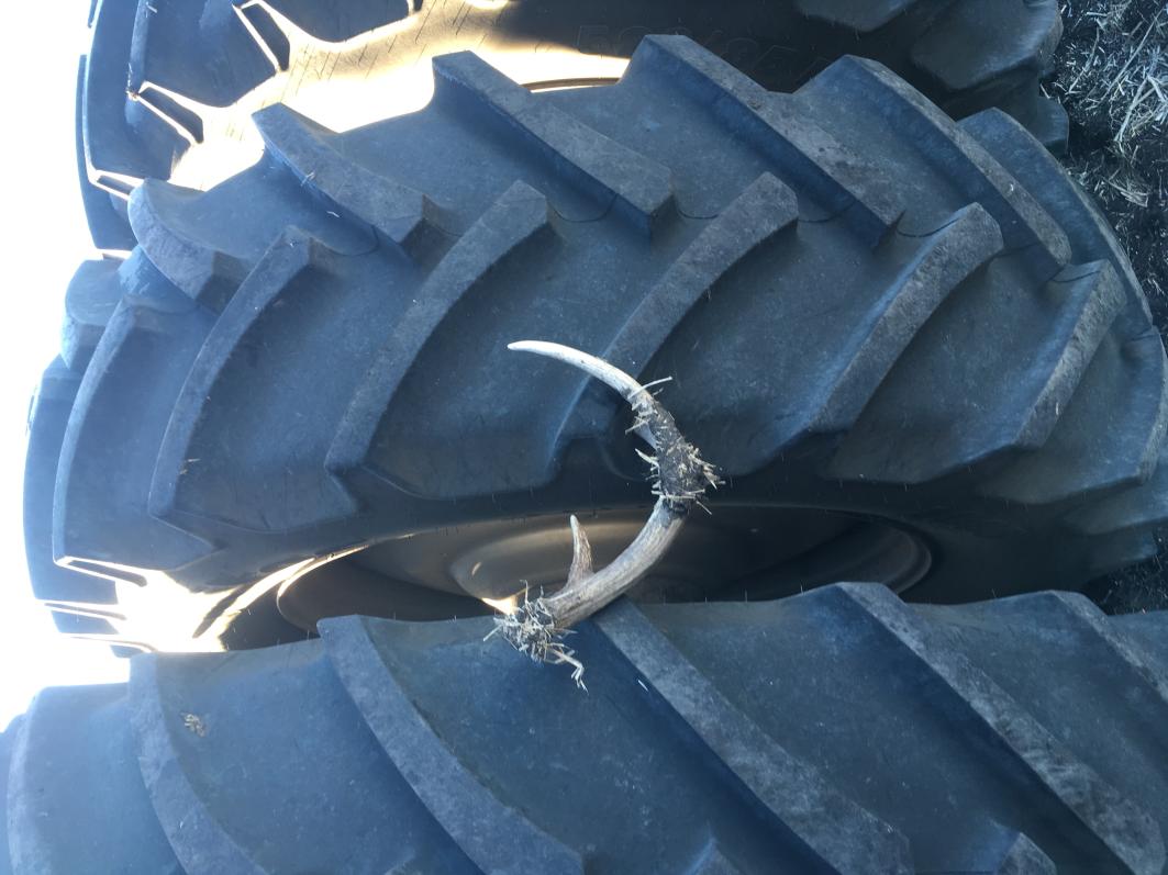

    Shed antlers are the big tire nemesis. Can happen when they are brand new.
    If there is somewhere that can vulcanize repairs it whould be good to know before you need them.
    We had a cultivator shovel stuck in one of the triples a few years ago . They came out and patched er up .
    We have been lucky , have never had an antler in any tire ever. The tire shop guy says not really an issue any more, they can repair effectively now in field

        If you farm in an area with lots of deer, the appeal of cool looking LSW tires would wear off really quick. Sure some punctures can be repaired but some can’t. And picking up a shed in the field is like hitting a deer on the highway-it’s going to happen.

          In some areas you would have a deer horn in tire like this several times a year.
            Absolutely, but many areas don’t . We have never had a deer horn tire injury in this area . Maybe just lucky

              However have picked up a shed in a 600. In the face out the sidewall. Needed replacement. Spent more on that in the first 300 hrs on having the tractor than in several years of tracks.
                first 10 hours , new tires, was fixable though
