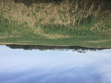

                With our dry summer and 4” of rain in the last 2 weeks it has revived our swathed canola, plants are just starting to bud and some starting to flower. I don’t think there is enough time to produce a 2nd crop so need a prescription to remedy the problem before it sucks whatever fertilizer is still in the ground. What do you all think I need to use to kill this aggressive growing 2nd crop canola?

                Sorry about the backwards pics but not sure how to rotate.

                  Put the streamer nozzles in and create rows next year? I hate wheat on wheat or canola on canola. But fighting volunteers can be expensive.

                    What about thistle control? I have a lot of juicy looking thistles in rosettes coming along with the second canola crop. I want to spray them before that heavy frost which could come any time now.
                    Other years that frost can really brown them off and then you’re supposed to wait for regrowth before spraying. That regrowth never seems to happen much and they are never leafy again.
                    So I’m thinking of hitting them with a litre an acre as soon as the swaths are gone. I virtually never see that good of a rosette while it’s still early. And that second growth canola has to be sucking ALOT of nutrients and should be stopped as soon as possible
