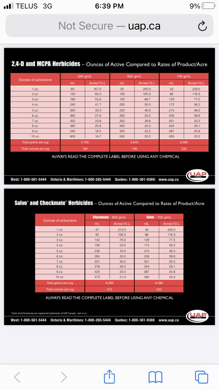

            24d mixed with glyphosate messes up the the action of glyphosate on grassy weeds? I have some hailed canola which I finished harvesting, and the stuff is regrowing from the stubble itself. I have never seen anything like it before. I am not concerned as the frost and winter will put it to bed. In fact I hope it will act as a snow trap. I’m more worried of winter annuals and possible grasses like that awful wild brome. That said, this canola stubble, which is going into barley next year, if it’s mostly broadleaf weeds present do I go in with 6oz of ester 700 and 1l of glyphosate? I want the 24d residual for next spring cause I can see canola volunteers being a real problem. My cereal stubble is messy with thistle as I didn’t do a preharvest application. Was thinking of a litre of glyphosate on it as most likely it’ll go into canola. Foxtail is a real problem and we cut around the patches at harvest so hopefully the spray gets into it better. Last year we had those spots in canola fields so they didn’t have preharvest. They were worked after harvest and I figure that was a waste as it made the problem worse.
            • Sodbuster
              • 1170
              How many acres does a 10 litre jug do at the rate of 6 ounces of 24D ester 700?
