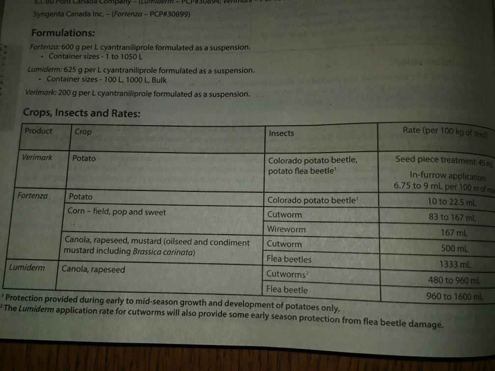

      Read em and weep. Look at the rate required for flea beetle control versus cutworm control(or suppression or what ever the "F" they are claiming).
      $o at $70-90 a bag how much flea beetle control are you really getting?
      Pirates!!!!! But we so willingly turn over the bounty!

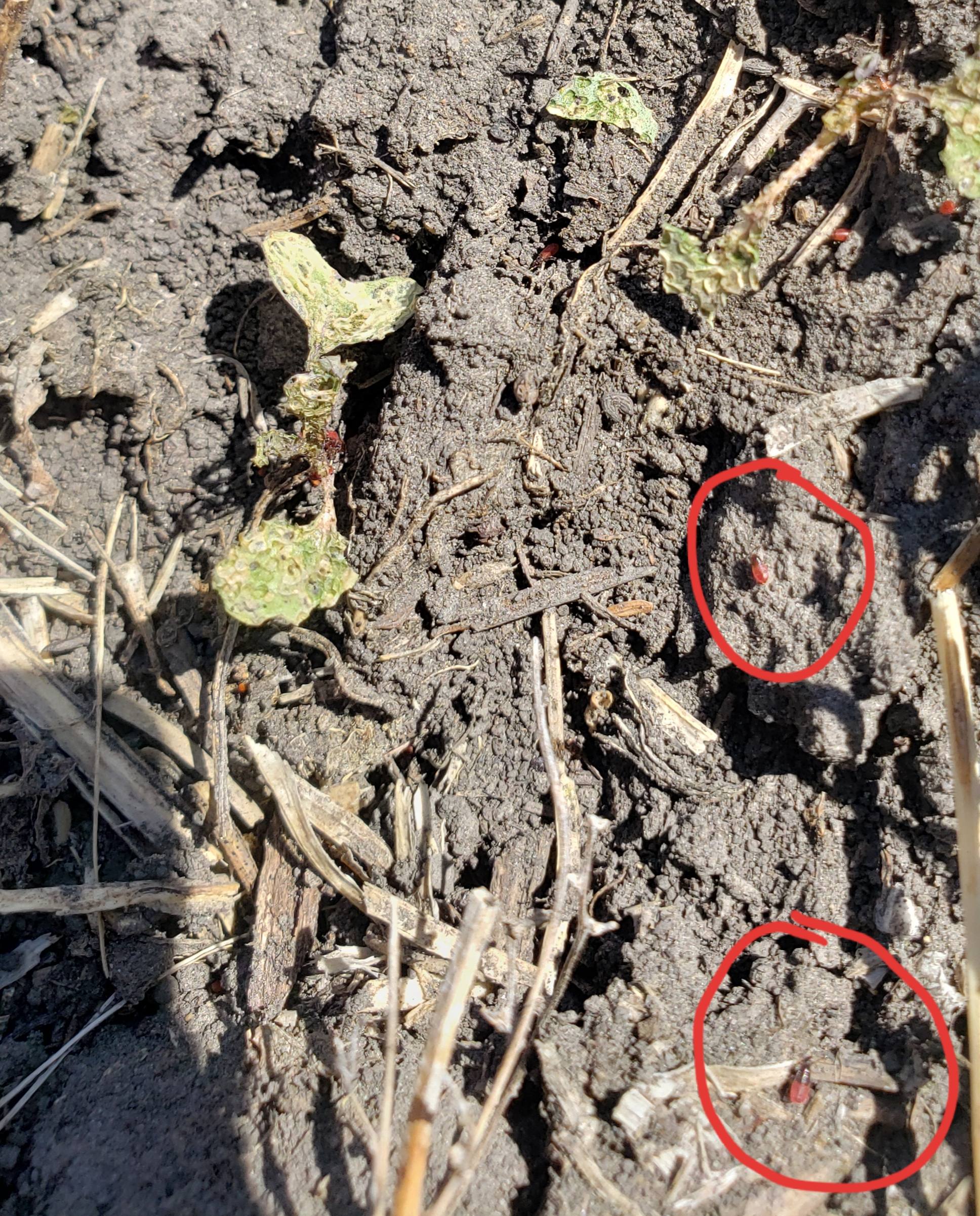

            Flea Beatles are bad but these devil beatles live up to their name.
              • 10012
              We don't have Devils, Fortenza Advanced seems to keep fleas down long enough...
              and apparently these DEVILS won't allow me to attach a jpg? Tried several pics?
