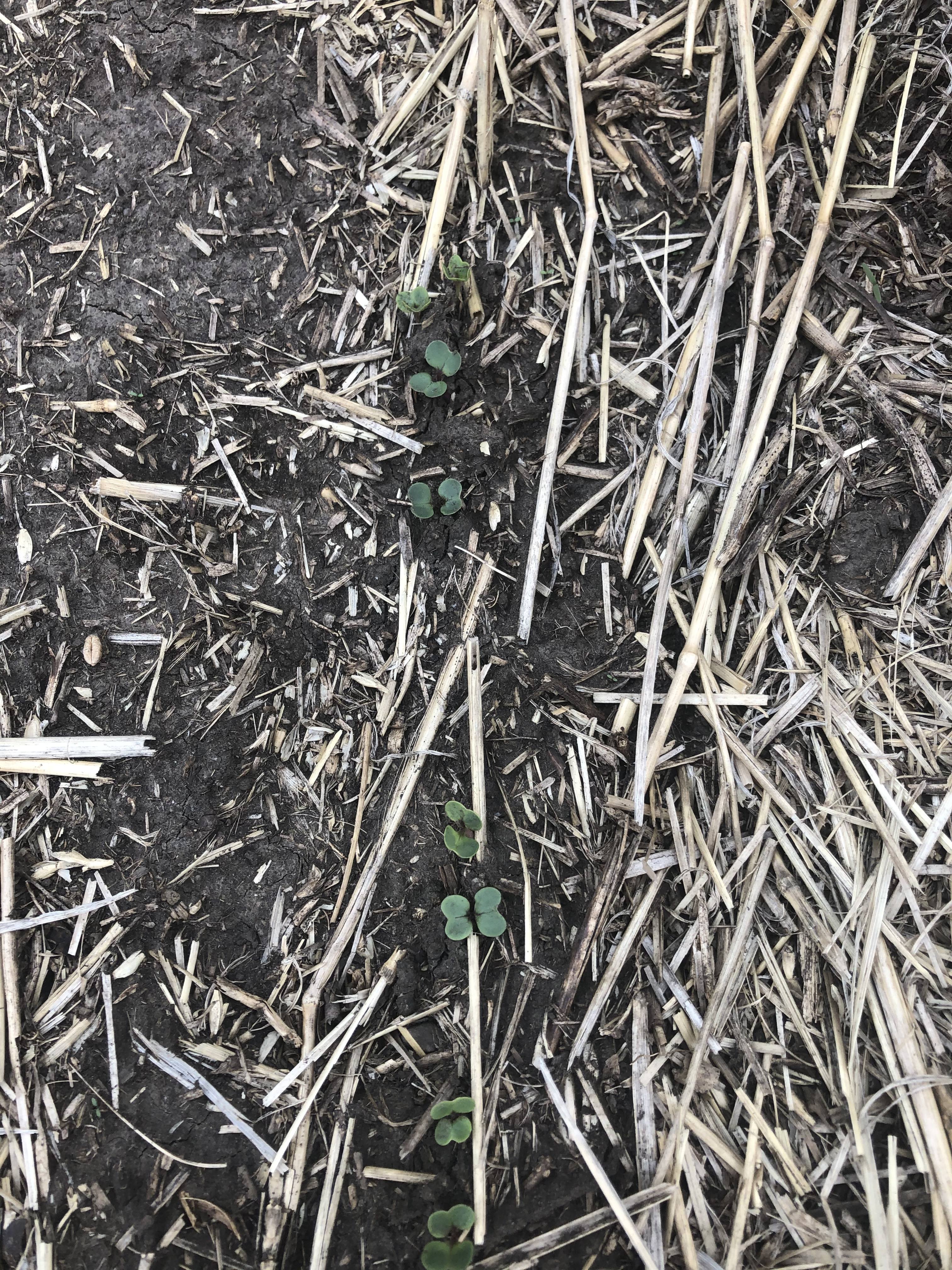

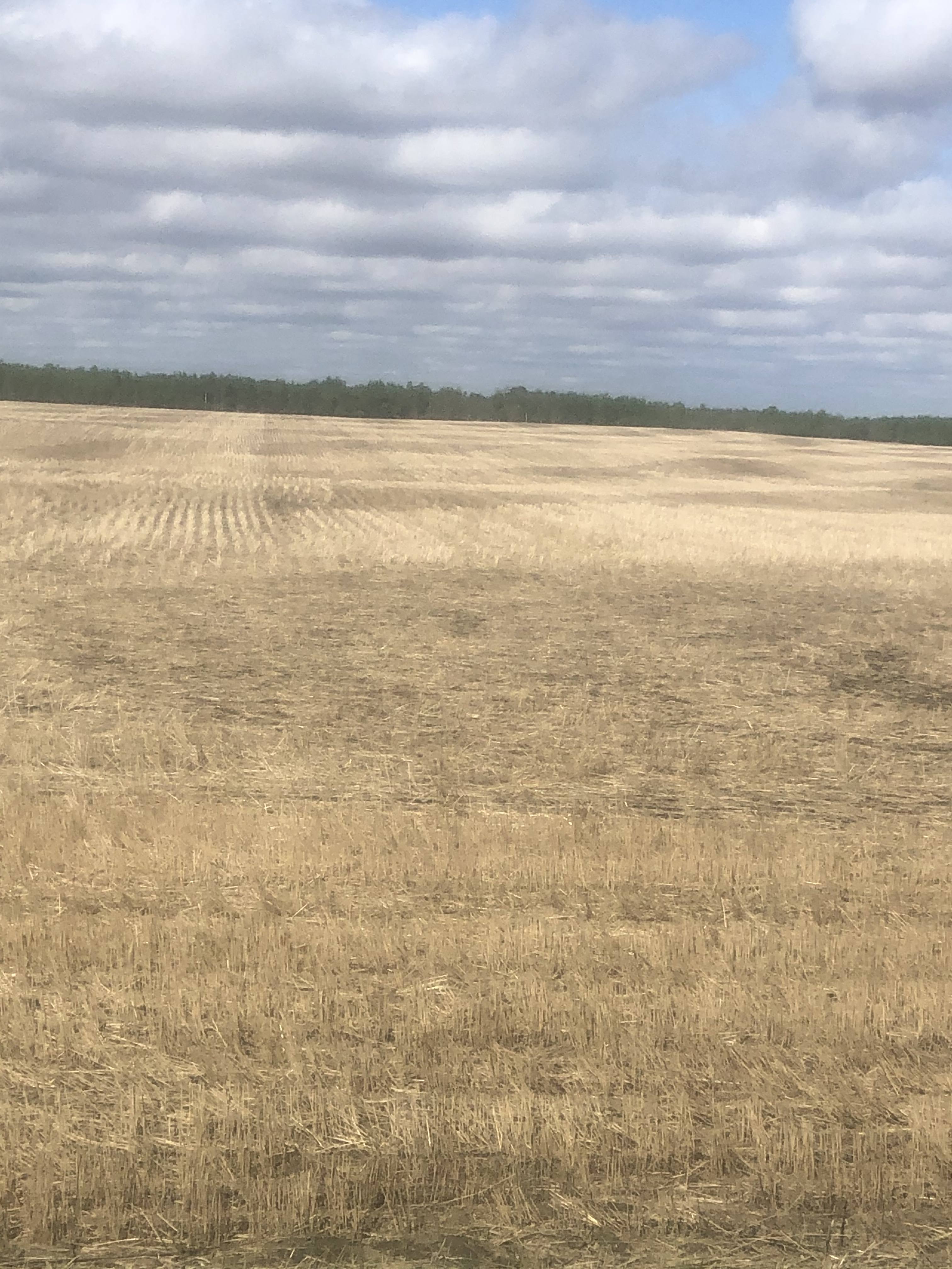

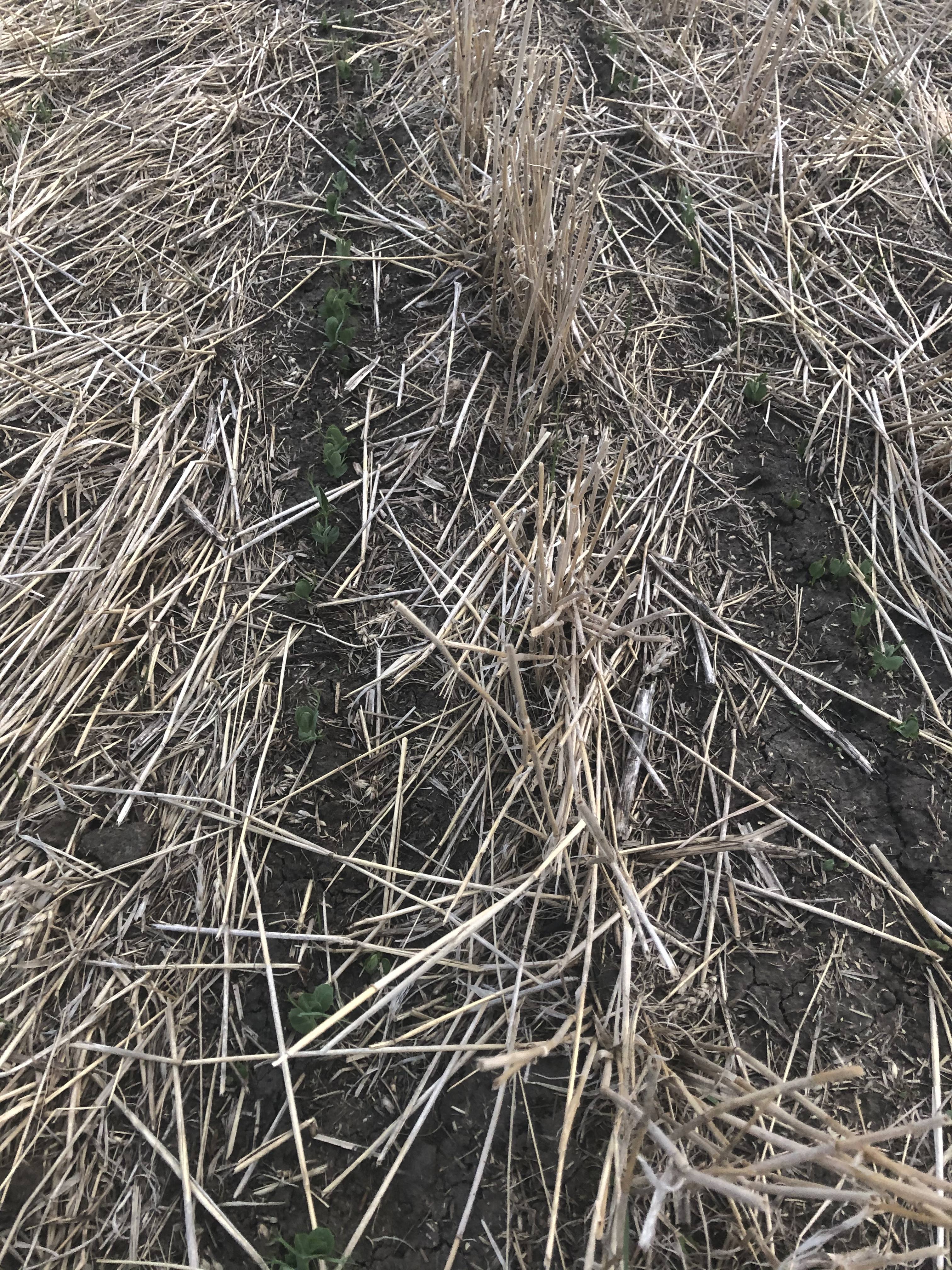

    Peas into standing wheat stubble , harrowed once last fall . Planted at 2 bus / ac
    Canola at 2 lbs / ac seeded into wheat stubble that was NH3 last fall , harrowed this spring
    So far looks ok . Very low flea beetle pressure and we missed the frost . A few days of heat is needed throughout this whole NW
    One thing that will also be noticed, no tire tracks or compaction issues behind planter even in the wettest areas . It will be an issue in some areas this year . Has not been much of an issue here the past 4-5 years being on the dry side during canola seeding time . Although most big carts now do have huge rubber for floatation it will be interesting to watch the next two weeks . May not show , depending on weather ahead but a lot of very wet ground just got seeded here the past 4-5 days . Hopefully all is good
