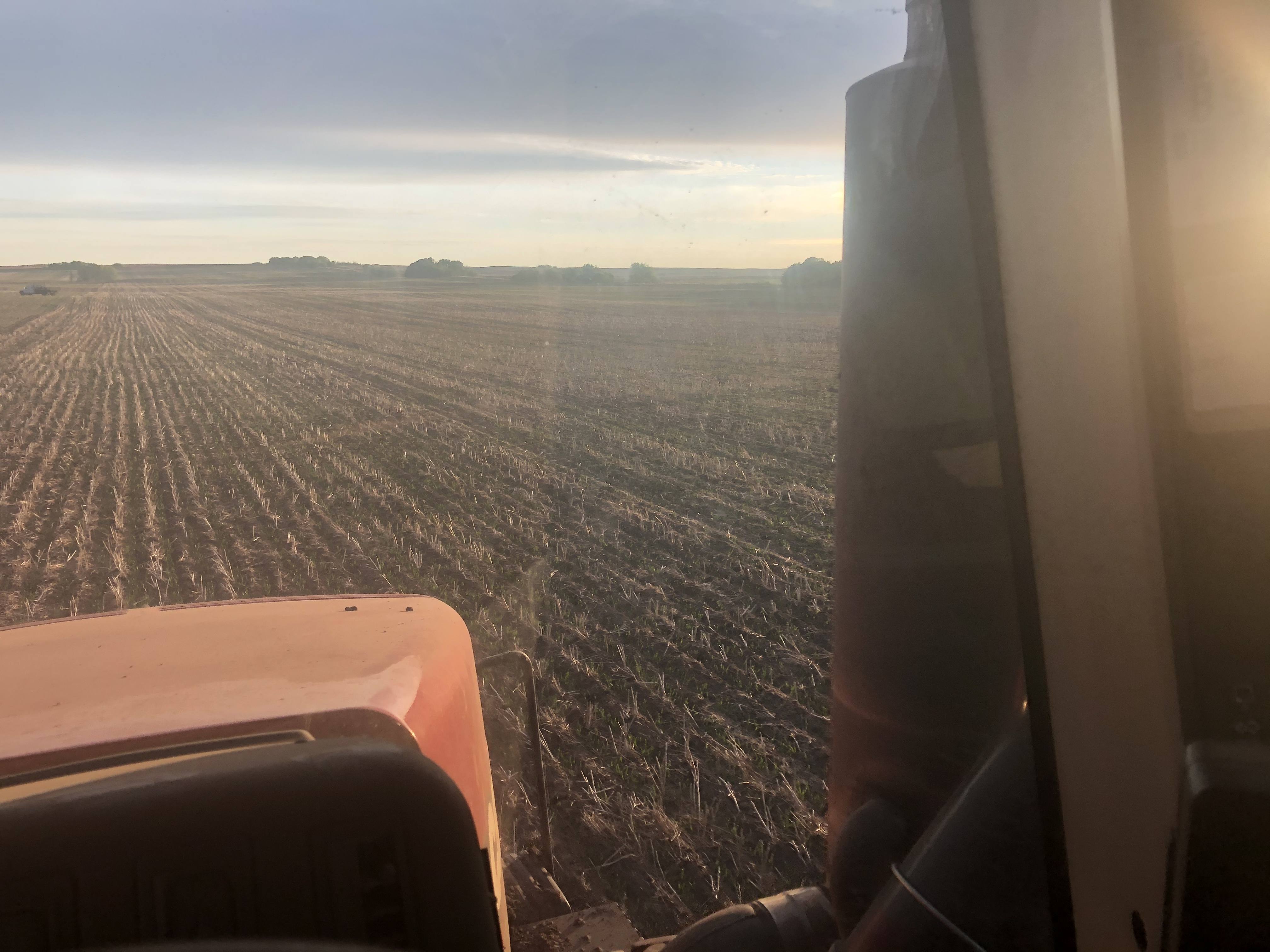

    Lol just running the morning shift ....
    Barley , will make far less stressful at harvest
