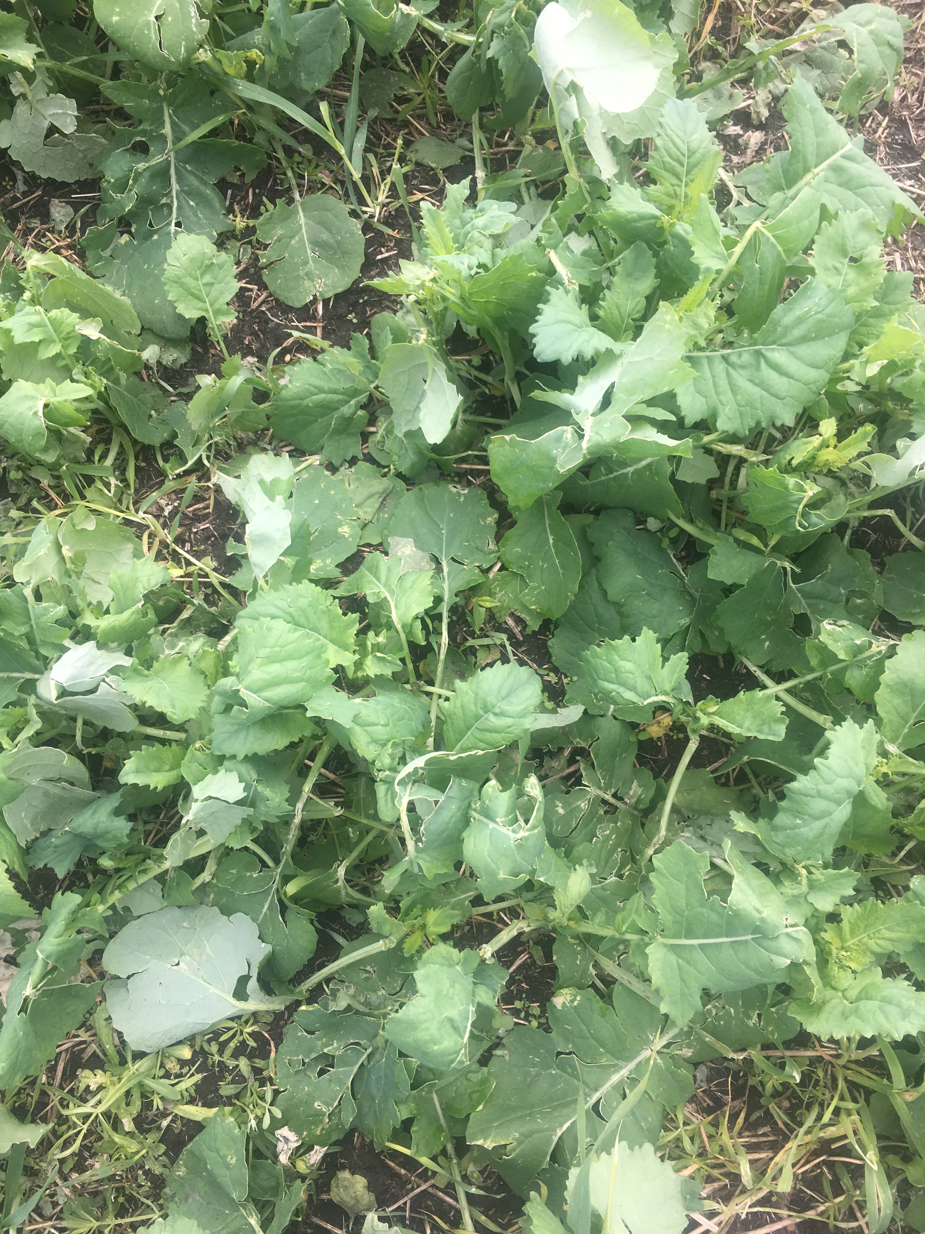

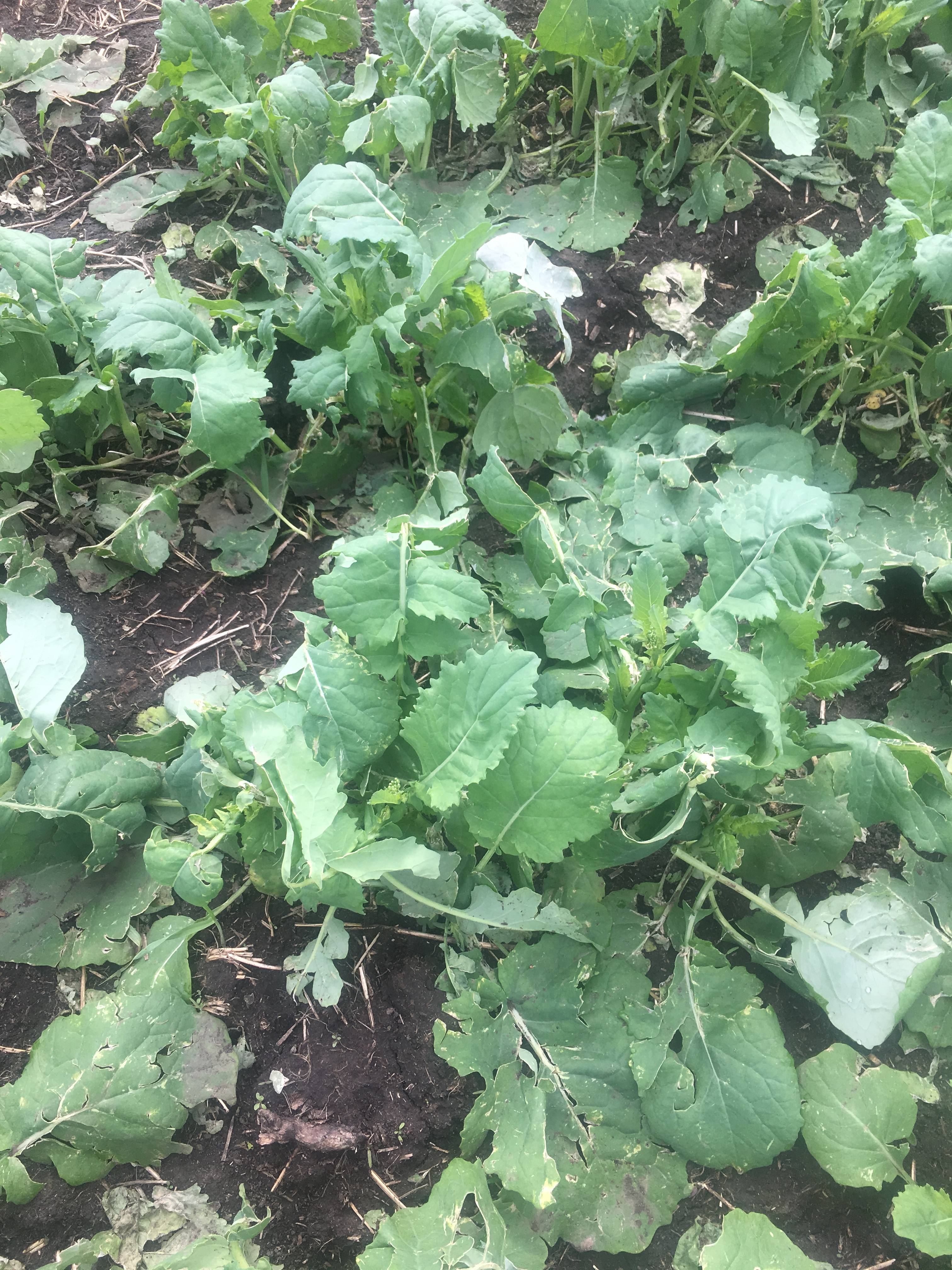

        RD does it look like this ??
        I checked this canola from NE of here that got hit Saturday
        Damaged bad but ... lots of regrowth already as of yesterday morning.
        New leaves starting and new stems a buds. That canola will recover very well in 7-10 days
        Products like releaf and or headline will help recover very fast . Plus help resist disease infection.
        We have used Alpine at 2-3 lt/ac with a glug of headline 👍
        The Alpine is a very cheap penicillin
        Hope that helps

          Sorry but it does help a lot . You will help gain 5 days maturity and maintain a healthier crop .
          Otherwise you may lose 8-10 days maturity and be very susceptible to disease if weather get wet . Like it might in the next 10 days
