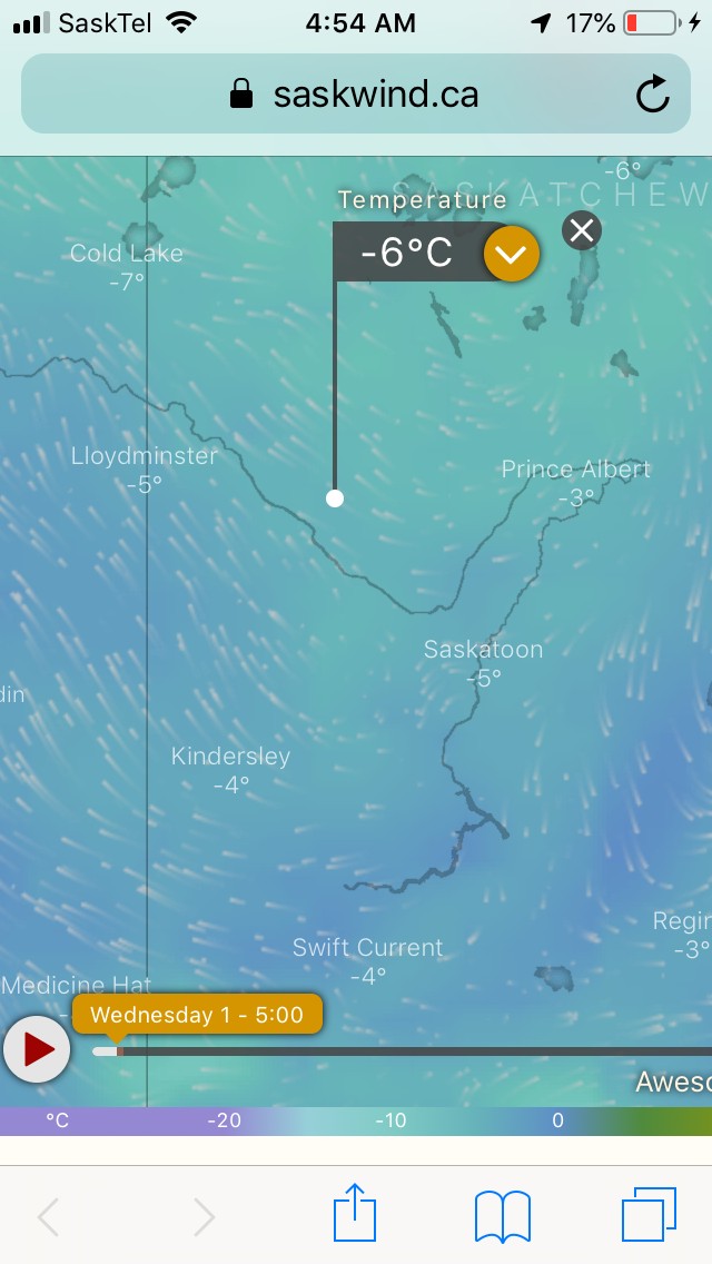

                      Brrrr........
                      Windchills of -13 here
