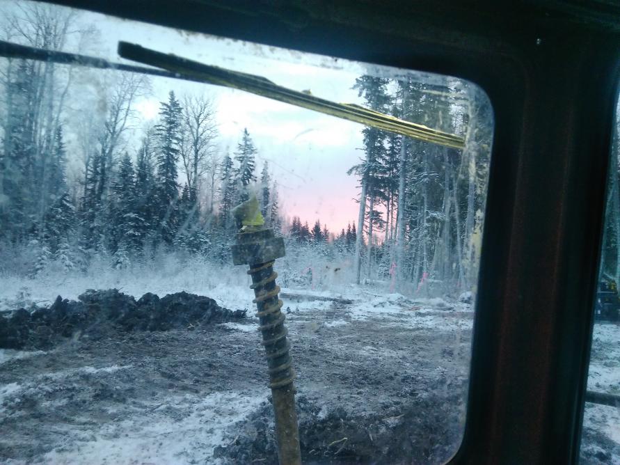

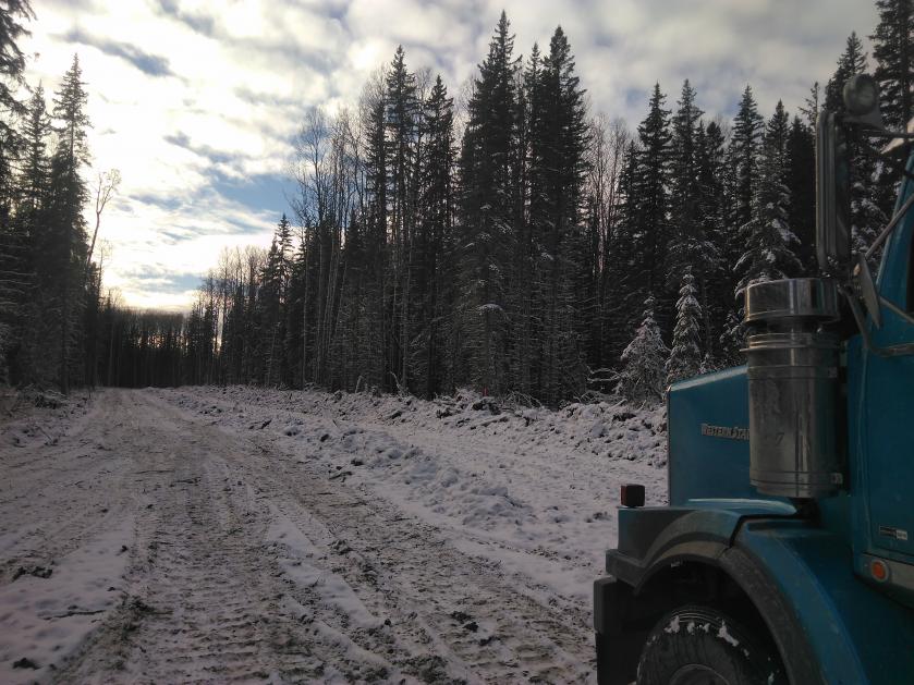

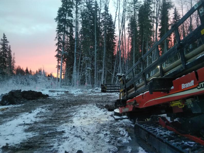

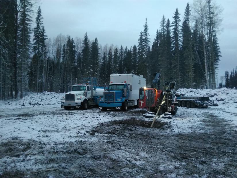

    pics from work
    Just three of us...
    In the bush by Fox Creek pulling in pipelines.
    Quiet. Peaceful. And nice views.
    This was just before Christmas.

    Whats pulling pipe, crossings? Road bore? Never seen that.
    • Klause
      • 3644
      Ya directional drilling. We pull in everything from fibre to oil and gas lines in field to supply lines to houses.
      Nowadays whole projects are drilled and pulled since trees don't have to be cut.
      Any slough, temporary or permanent waterway, or other
      environmentally sensitivee areas must be directionally drilled.
      The technology involved evolves rapidly and it's amazing what we can achieve today over 10 years ago... Vs 10 years from now.

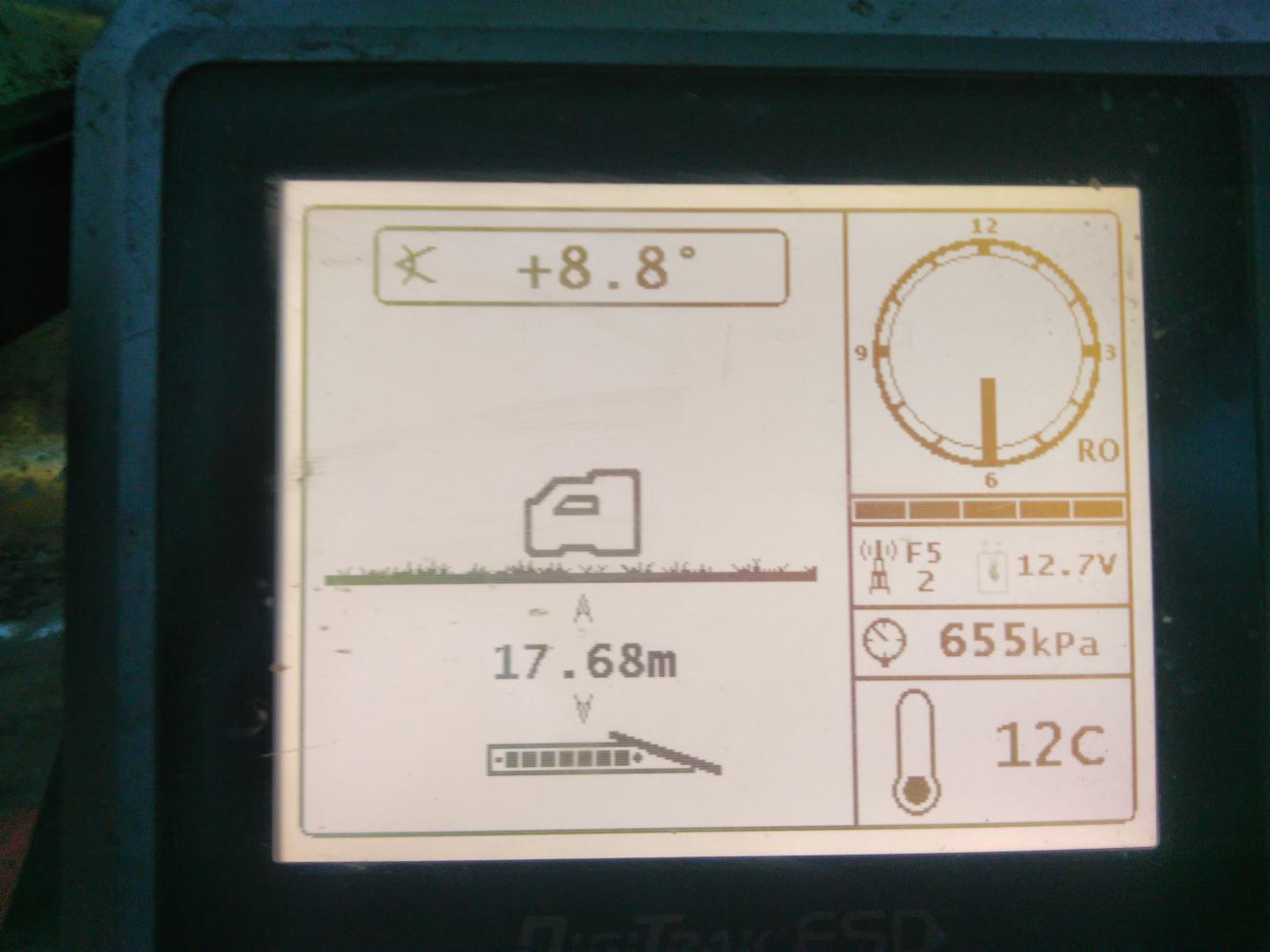

        What tech is involved in knowing where the end of the bore is at? How do you drill under a river from both sides and meet each other?
            And that is the first time I've heard anyone refer to focx sake by such generous terms. Not my favourite part of the world, but I'm not a big fan of tree or muskeg...
            We drill from one side to tell other.
            The end of the bha right behind the drill bit has a sensing unit called a sonde that sends a front and back aignal at a specific angle. Depth is measured by the distance between front and rear points.
            You spray paint your front and rear points on each rod and steer by the "clock"
            Simply walk across ice, or a boat on open rivers.
            Or you can wireline and send data back that way instead of the wireless "box" if you're deep.
            This is what the steering screen on an F5 looks like.
