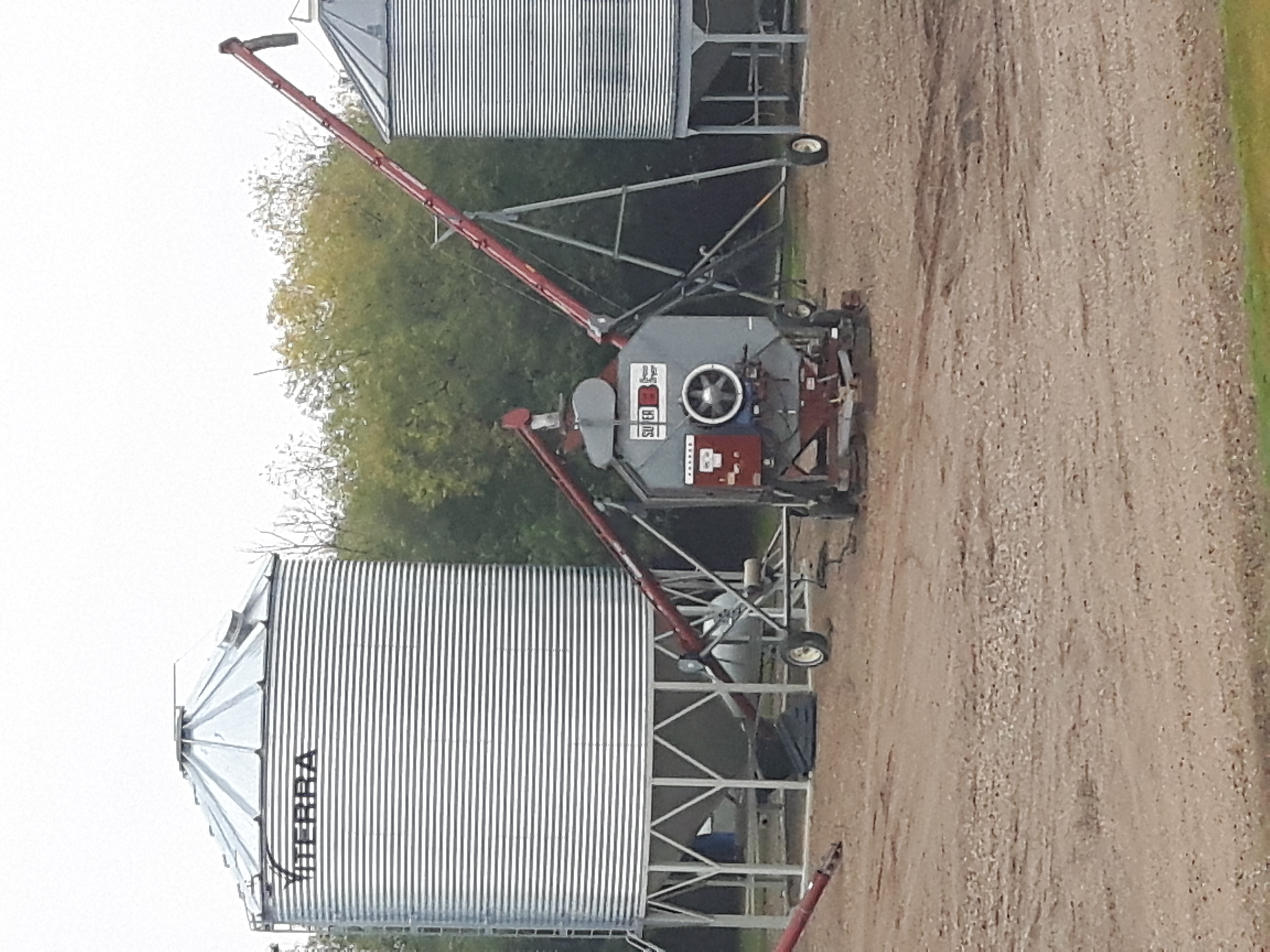

      I'll share my STO setup. I put the augers with electric motors and dryer in a shed when I'm done for the year. Used the setup 4 years out of the last 5. Two hopper bins. Wet 2000, Dry 2300. Farm Fans 180 dryer. Enough amps between them to run everything. Toughest part is lining up where the dryer needs to sit every year then putting a couple railway ties under it. I don't think that you need to have a dryer that can keep up to your combines for a day. I'd need three times the capacity dryer for that. You need hopper bins maybe with air to keep grain for a few days while the dryer catches up. A couple 10" loadout augers can move grain around in a hurry. Just before this wet crap hit I had a whole bunch of wheat swaths out there. Thought I'd speed some along by swathing. Took it all off at 16. Rain hit and I spent the next few days drying it. My drying is sitting idle now. Bigger capacity would have cost me more but not helped me any.

          Our cheap set up..4800 bushel wet bin..2200 bushel dry bin.old super B dryer that runs great.small 130 bushel dryer but run 24/7 if we get behind..have air in every bin for the not so wet grain. Or cooling..
          Dryer goes in shed for off season.

                  With the larger wet bin we can combine the whole day with dryer running .we run 1 combine..
                  Had smaller wet bin before and was full to quick..we empty dry bin at night or early morning.
                  Ideal would be dryer twice the size..dry bin twice the size..
