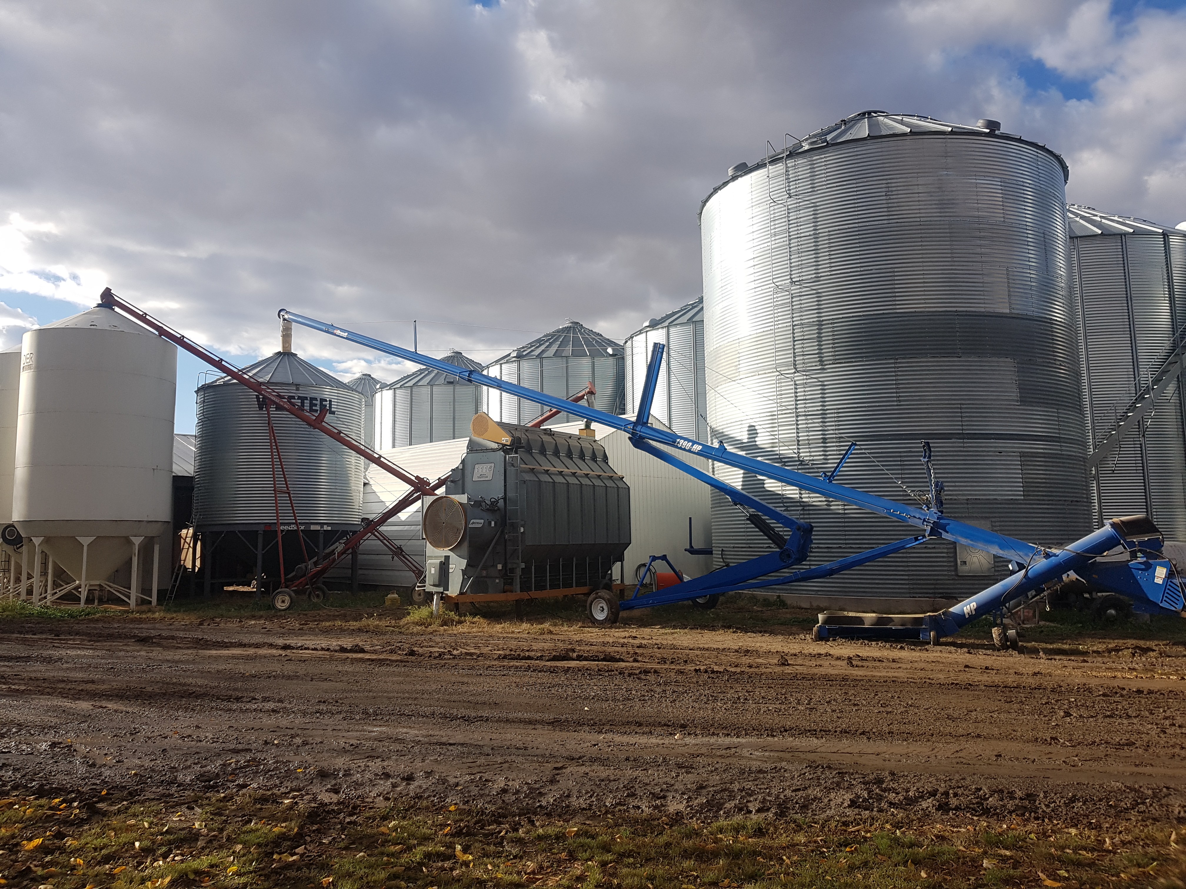

        not much to look at. but it works. been wanting to make something better for years but keeps getting put off.
        use it as a continuous batch. gsi dryer. i like it. holds 450bu. load in wet is a 7", load out a 8". which only operates the load/unload time at half the speed its capable of. but will dry down 18to19ish to 14 wheat in about 25 to 30 minutes then a cool down of 15 minutes, then load in/load out cycle in 24 minutes. so roughly 1.25 hours a batch.

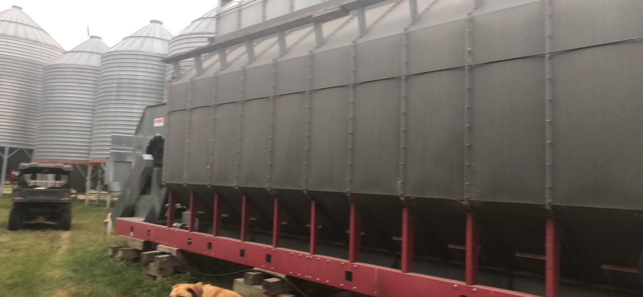

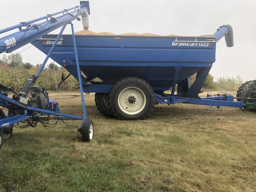

          Automatic system. Its tied to fill augers and unload augers and can be run 24/7.
          Canola under 20 and wheat we have done.
          Into bag as if you screwed up easy to deal with.
          Never a problem yet.

          We use swingaway auger to dump 13 in and bigger tractor for tough grain.
          8 in supercharged to load dryer and wet bin has air.
          8 in super charged to empty and 10 in to load cart for bag or conveyor.
                Your system is simple, just like I was hoping to set up. Trying to figure out which hopper bins to attach to the dryer. Your dryer system looks so small next to that row of big bins. Suggests that you use air on the bins and only use the dryer a little bit, which is exactly what I am looking to do. Chuckle at your swing auger reaching right over the dryer to fill the wet bin. Wet bin looks like it can only fill the dryer, nothing else.
                Thanks for posting the pics.

                  [ATTACH]3404[/ATTACH]
                  [ATTACH]3405[/ATTACH]
                  [ATTACH]3406[/ATTACH]
                  Is the dryer running in auto batch mode or continous flow?
                  System looks nice. Is the plan to eventually tie it into those new 55,000 bushel bins that you are ordering?
                  How many bushels of wet bin and how many bushels of dry bin do you have currently? Dryer looks to be 12-1500 bushels/hr taking off 5% in wheat. Must keep one guy busy moving grain away from the dry bins.
                  Thanks for the pics.

                      Our cart is used for scale and we know what's in each bag. Bag site is just outside the yard so easy to get back but the guy is busy.
