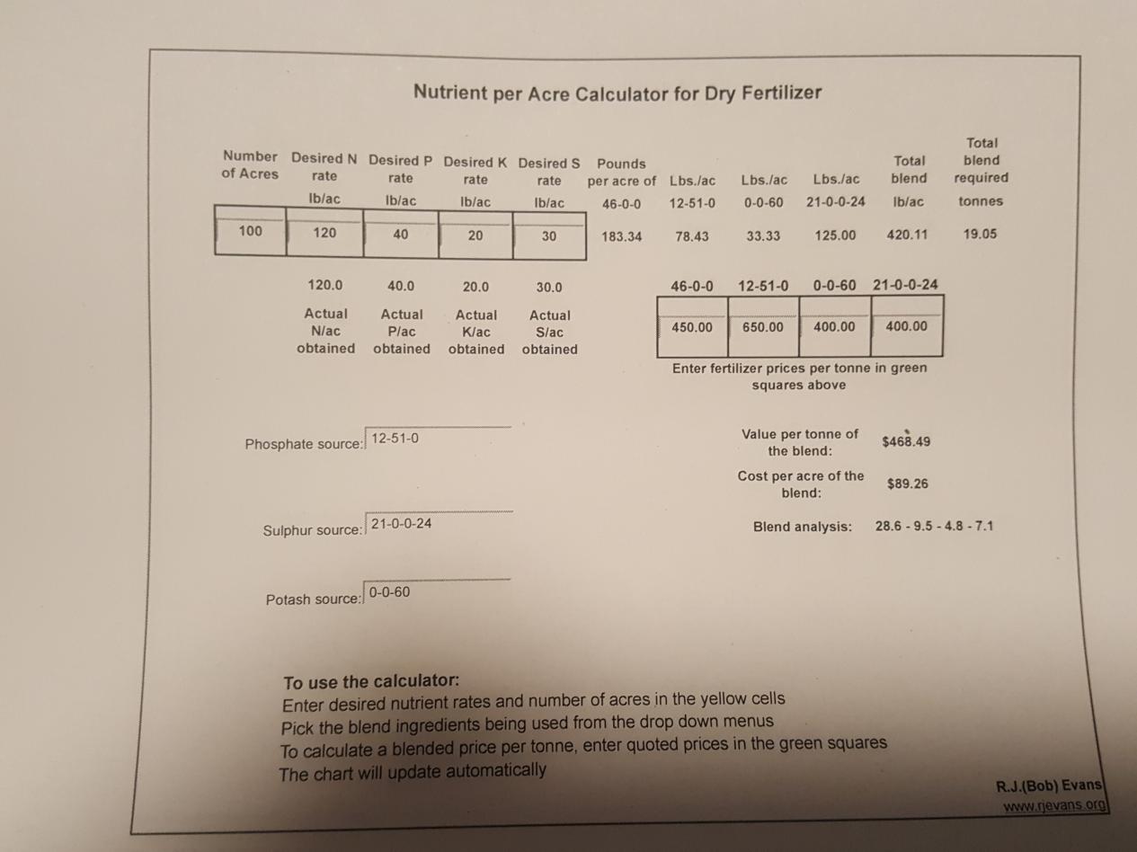

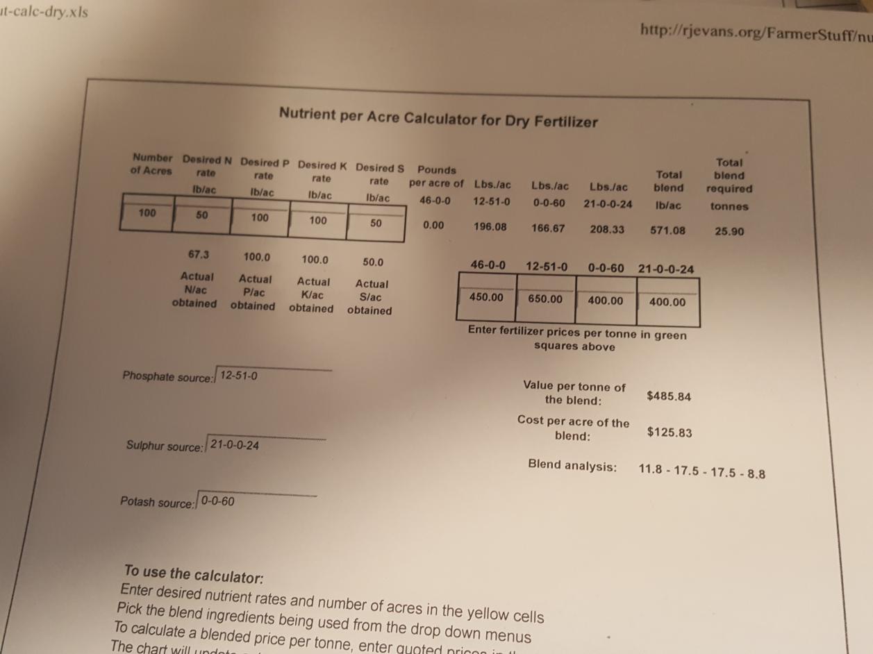

                I'm failing to understand the purpose of this trial. Now you are over applying 3 of the 4 nutrients to grow canola, 50 lbs of N is the limiting factor of your yield potential and you've managed to spend a extra $35 in the process.
                120-40-20-30 = $89.26
                50-100-100-50 =$125.83
