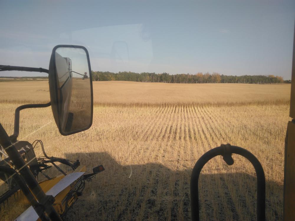

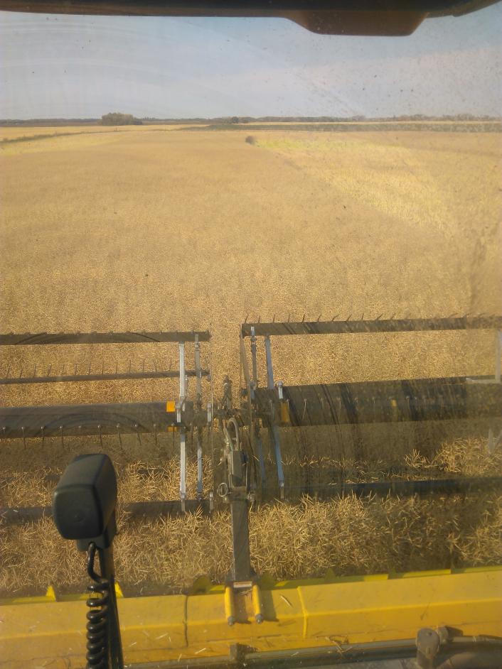

    Are we sure that the high rates of N recommended are actually what good canola crops need?
    We grew this canola on a 1-2-2-1 ratio. Our best canola this year.
    Yielded very well.
    That ratio is European protocol for canola vs. Canada's answer of more N all the time.

  • Klause
    • 3644
    Also notice the even stand... Without a half million drill. Lol.
        ..........doesn't look like the most challenging topography.

                This field was 50-100-100-50.
                We have another at 30-50-50-30.
                Actually rolling land... But you'll see in the pics of the hill field the other trial is on... Drill seeds the same all the time.
                Actually we've gotten to the point where some guys were in Sask are using more fertiliser than they do in Europe... But only growing half or a little less than half the crop.
                Potash is the big one nobody wants to use here... Pouring on a bunch of N without potassium is silly. And just because we have it a mile down in the ground doesn't mean the plants have it... Soil tests lie a lot about K.
                I'm not sure it's the potassium the micros with it, the salt index balancing the pH ot a bit of each, tbh
