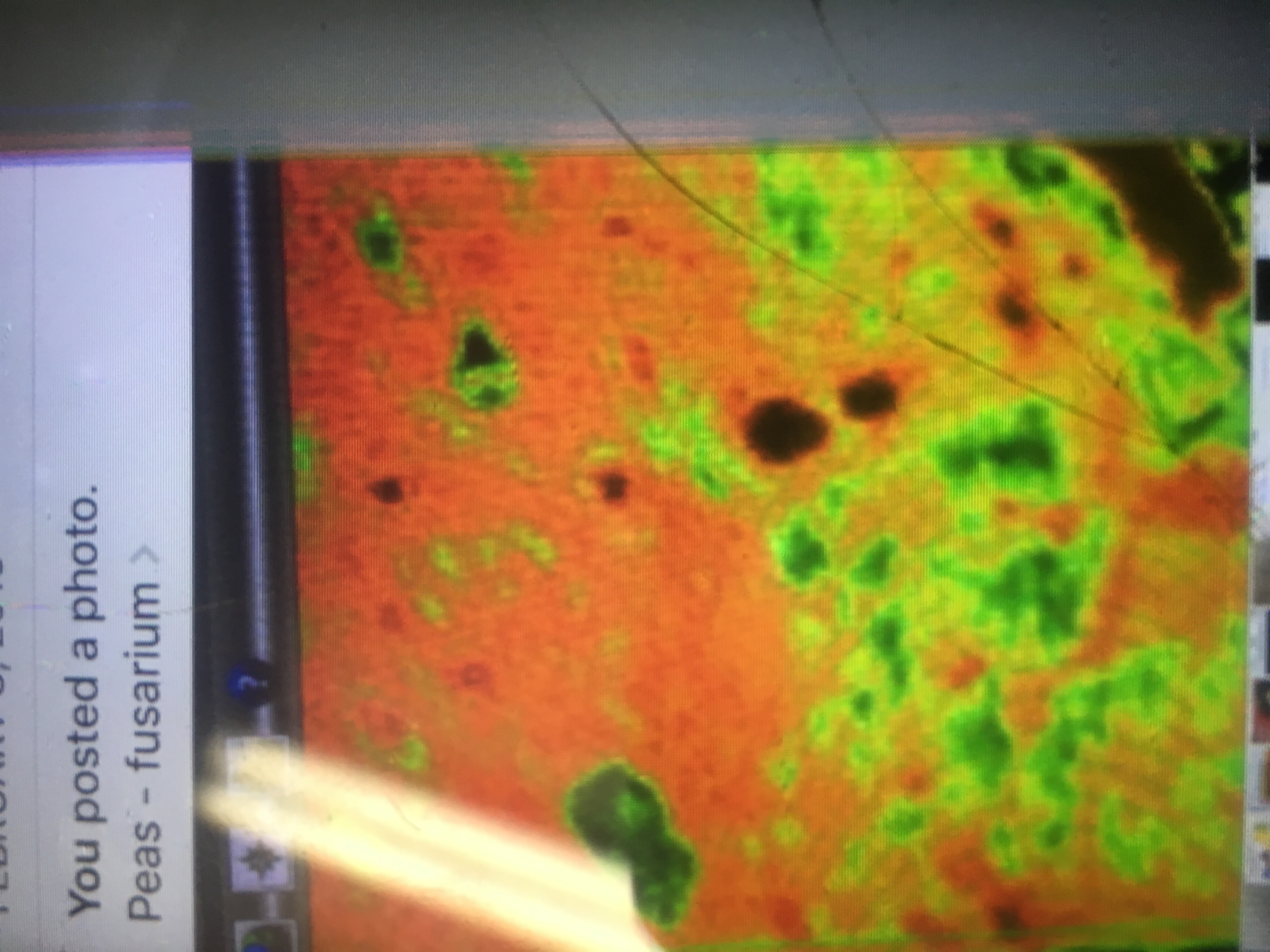

          Just tweaked my brain after 3 years ago when we got hit bad with fusarium root rot in peas on hrsw stubble. All anyone could talk about was aphenomices . And I found this infra red shot of my peas in late July and it got me thinking about all this agin ...
          That 1/4 section was 75 ac hard red spring wheat stubble and the south side was winter wheat stubble .
          The spring wheat on the north side was a heavy crop , 70 bus / ac , and the winter wheat was a light crop with winter kill areas for the late winter storm that year with high winds that sucked all the snow cover off those areas .
          Way less wheat straw on the south side and virtually non existent in the winter kill areas . Those areas (green paych's) the peas were perfect , the north end was a complete write off
          Just found it interesting to go back and look now that this issue has popped up again
