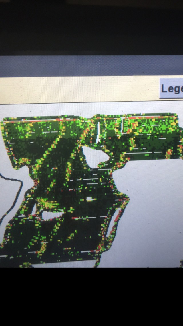

      Lance on the top , Kugler 178C after
      8 bus/ac difference .
      Agree do your own on farm in real life.
      How many scientific studies are done on herbicides to see negative effects are done to tell us how safe they are and who funds those scientific studies ?
      Not saying peer reviewed studies are not usefull or important they are . But they are not the end all be all of products in the real world .
      • BreadWinner
        • 1497
        Looks like your canola got a yield bump from the N topdress. I would say canola fungicide in our area was a waist of money last year. Did side by sides with check and ATP topdress and found the same as you. Fungicide was same yield as check and Topdress got a nice 5-8 bushel bump. Did you leave a check strip in that field?
