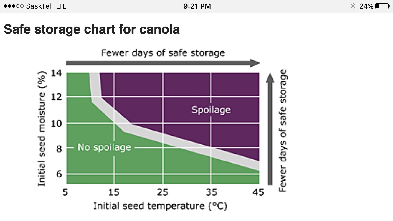

        • 17505
        Ache.... I was just about to post that chart but was looking for one that went higher on the moisture scale. the line is going almost straight up at that point so maybe higher moisture wouldn't mean as much as the temperature it is going into storage at.... speaking of temperature, the heading on the bottom chart axis states "INITIAL" Seed Temperature. Holy crap.... can you get it "cooled" fast enough to prevent spoilage if it went into the bin at say 10-15 degrees? Most of the harvesting under these shit conditions would have happened during the heat(relative term) of the day..... Kinda scary!

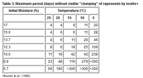

          Here is the chart I attached. Please note this is the maximum days before clumping. Other research has highlighted that higher oil content in today's canola has likely lowered these "safe storage" values.

          I would be extremely careful relying on air bins with high moisture canola. Forecast temperatures for the next while will not be low enough to freeze a bin.
          Taking some out and making sure there isn't a pile/cone on top would help.

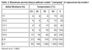

              • 17505
              Also notice how ambiguous the first chart is...... no mention of actual number of days because I assume there is no hard and fast rules as to how long it would take for the heating/spoilage to occur.
              I would think moving it would also help.

              Sorry 101 for double posting..... never knew you posted the same chart.
