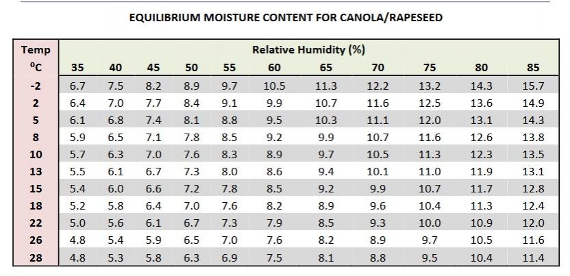

    Here's another chart from PAMI showing what a guy can expect for air drying based on temperature and RH.
Name:	Equilibrium levels for canola moisture.jpg

          Interesting chart 101
          I guess that means that right now at 8C and 90% Humdity i am actually not drying my canola but adding moisture?
          I have always felt that the drying front in a bin is at 100% moisture and turning off any fans except in a heavy rain is counter productive. Need to keep that moisture layer on the move.
            • 3959
            If RH is 90% 24 hours a day it is doubtful any drying will take place with unheated air. There must be some part of the day with lower RH for natural air to work. A little supplemental heat can keep the process going, but need to keep air flow rates up.
