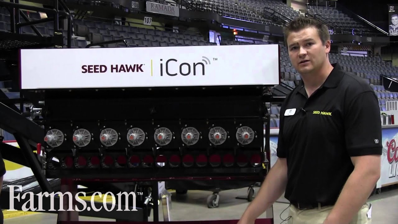

            I looks like Seedhawk is at the top off the list as best now?
            We will find out when independent farmers have a chance to operate them.
            Cost?
            I pad interface?
            Electric motors?
            Scales?
            Calibration?
            Simplicity?
            Weak points?
            Service?
            Reliability?
            Time will tell. Technology is our friend like it or not. No one has a phone older than 5 years old, many of the current tanks are old.

                  We did a walk around video interview with the Seed Hawk guys last week at the Farm Progress Show. Here is their overview. Take care,
