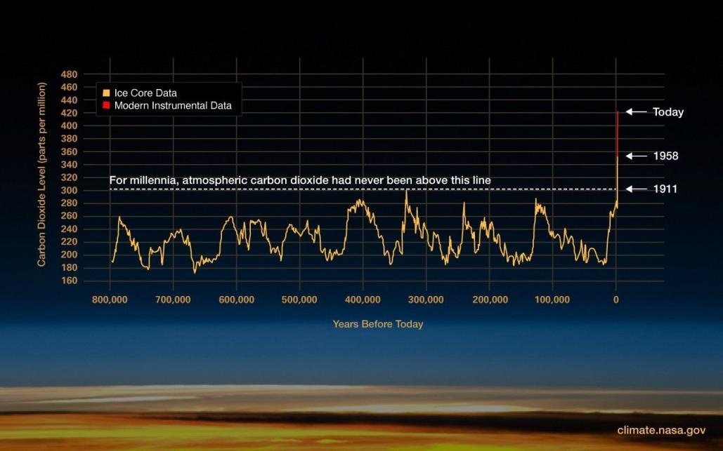

        You must have got too much carbon monoxide Flipper! LOL
          • 13439
          Flipper is a flat earther!
