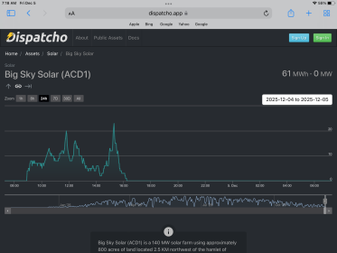

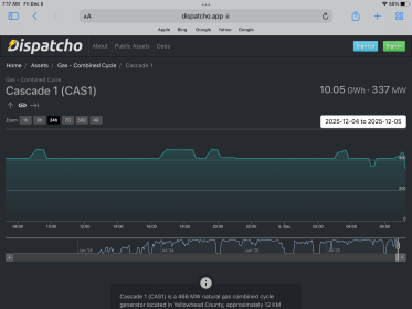

    Proponents of renewable energy promote it an a technological advancement over traditional generation sources. I went on the Dispatcho website which monitors every commercial electrical generation sight in Alberta. It can give you daily, weekly or historical graphs. Looking at the graphs of solar production from yesterday I found it interesting that in both central and southern Alberta production went down between Noon and 2 pm, basically the highest point of sunlight in winter. Natural gas produces power at a very consistent level, as evidenced by the graph, Solar seems to vary almost minute to minute. But remember Solar is a step forward.

    A little more in-depth. Chuck2 says the cheapest form of new generation is solar. A little research shows that solar infrastructure is roughly $1 million per megawatt. So the above installation Big Sky Solar is 140 megawatts of panels so roughly $140 million. Looking back on Dispatcho, in July this solar field will produce close to its rating of 140 mwh for about 11 hours a day, roughly 1500 mwh in a 24 hour period. Conversely in December in the same 24 hour period total production is 60-70 megawatt hours. So the question becomes how do you make this field produce power 24 hours a day 365 days a year. In the summer not that complicated. 1500 mwh/24 hours equals 62.5 megawatts per hour. Obviously a portion of daily production goes to charging a battery for release during the night. Let’s use a consistent production of 40 mwh. Let’s size the battery for summer.
    Battery sizing formula 40 mwh x 13 hrs x1 day of autonomy lithium battery efficiency .855 = 444 megawatt hour battery. Pricing I found on industrial batteries was $2.5 to $5 million per 10 megawatts. We go best price. 444/10 x $2.5 = $111 million. Not terrible, doesn’t quite double the cost. Now let’s look at winter. Same 40 megawatts per hour. Solar system only produces 71 megawatts, so what 23 hours of battery usage?
    40 mwh x 23 hrs x 1 x .855 = 786.6. 786.6/10 x $2.5 = $196.65 million. Starting to add up. Now the real conundrum. How many days of autonomy? Not enough production from the solar panels to charge the battery at all. Low production will occur through December and January. Is it even possible to build an industrial solar system that could reliably provide electricity 365 days a year? I don’t think you could afford the battery! And if you could what would the actual cost be per mwh when a 140 megawatt field only produced a baseload year round of 40 megawatts per hour?
