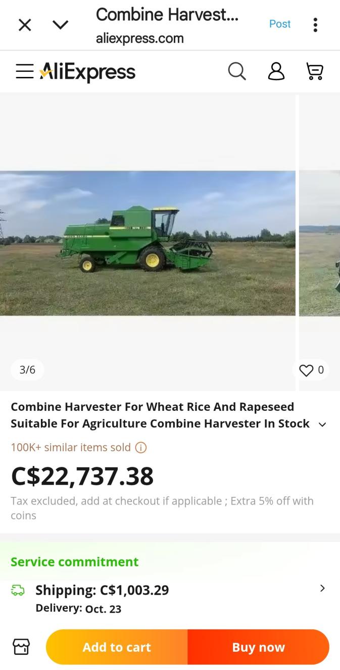

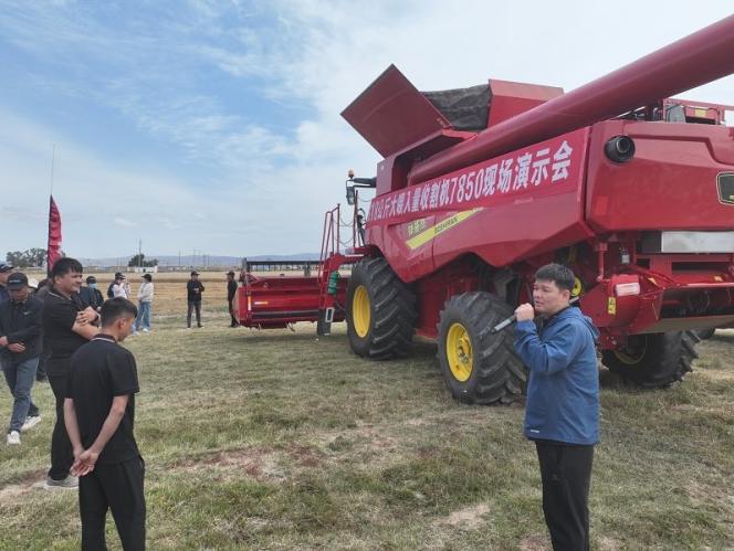

              Also this swather and S690 DEF level gauges are STUCK never change. We
              DELETE every thing and phuck the climate! F the EPA and climate NAZIS!
              S780???
              Probably doesn't need anything deleted ?
              I we think CHINA EV 's are going to be marketable, what about the mothercorp knock offs?
              Reported available in our competitor Brazil?
              "Yeah you can buy one in Brazil for 1/4 the money for what the Deere cost you and no Tier 4 emissions ."
              Looks odd with that 24 ft head?
