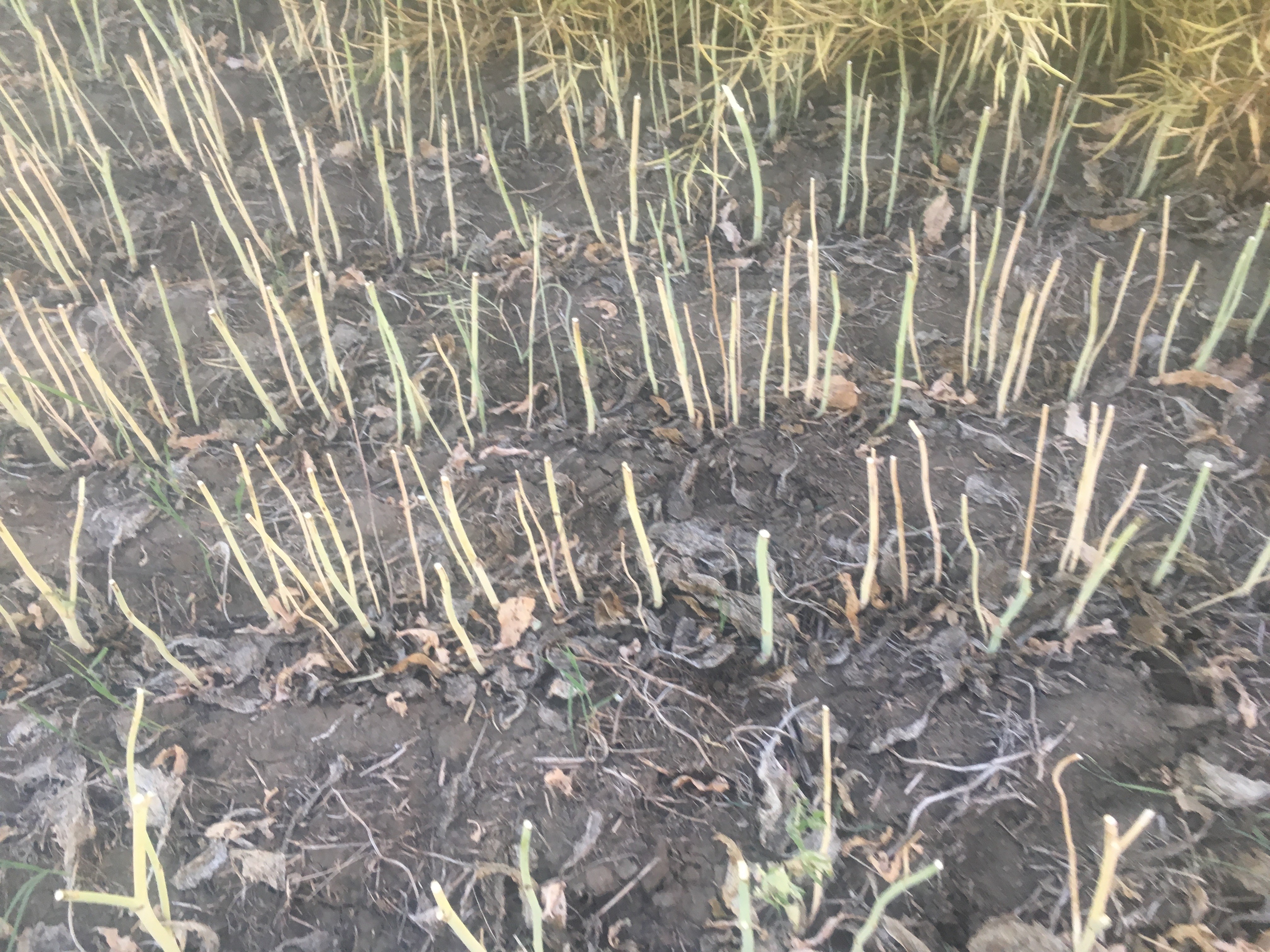

        Going to start to swath the canola seeded with planter today . Will get pictures of stand , swath and stubble . Curious to see what the stubble will be like at 2 lbs / ac
        Will post pictures later today or tonight .
        When we get to the side by sides with the drill at 4.7 lbs I will take pictures and do stubble counts as well .

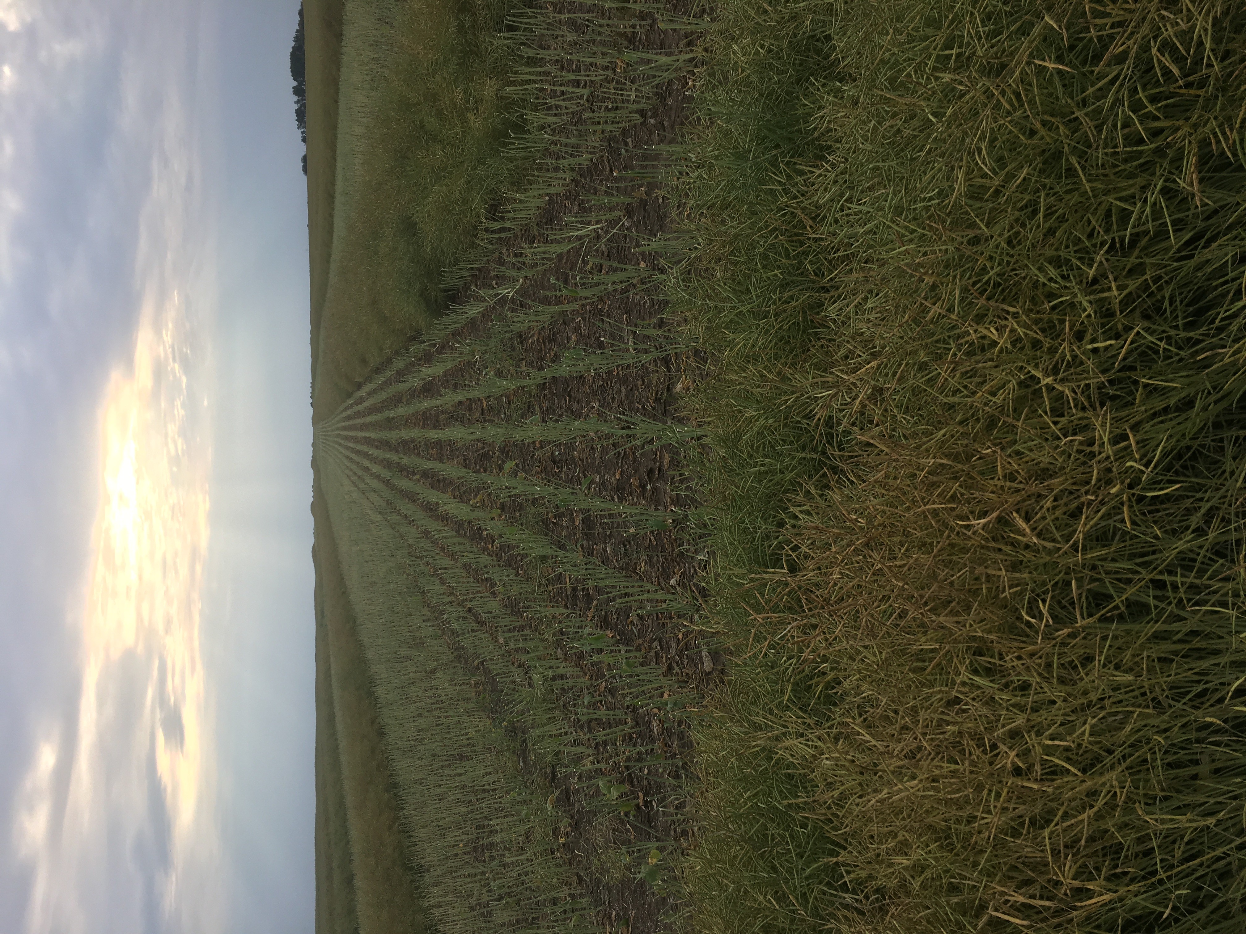

          • 22657
          The first field , 45CS40
          Interesting to see , most plants are about the same size and maturity. Very nice to swath .

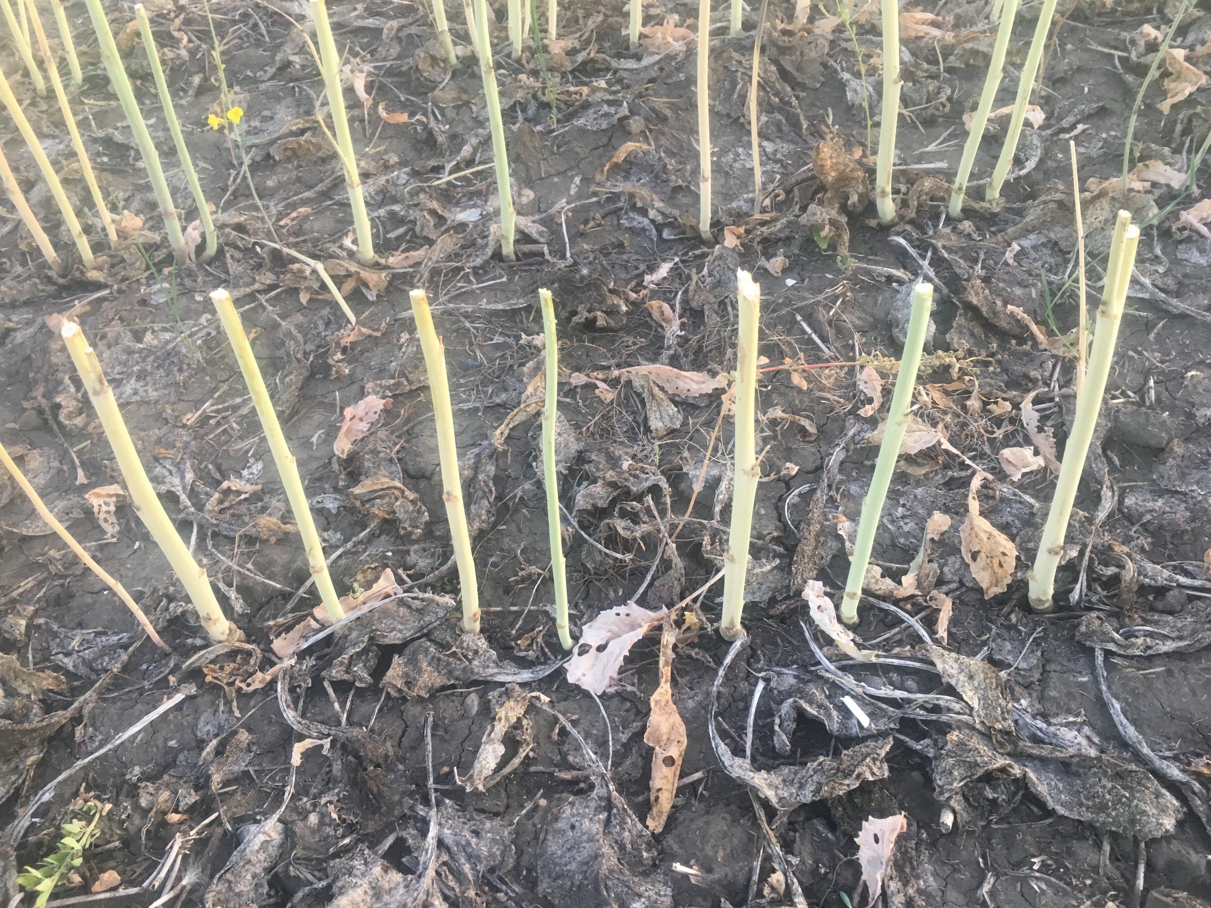

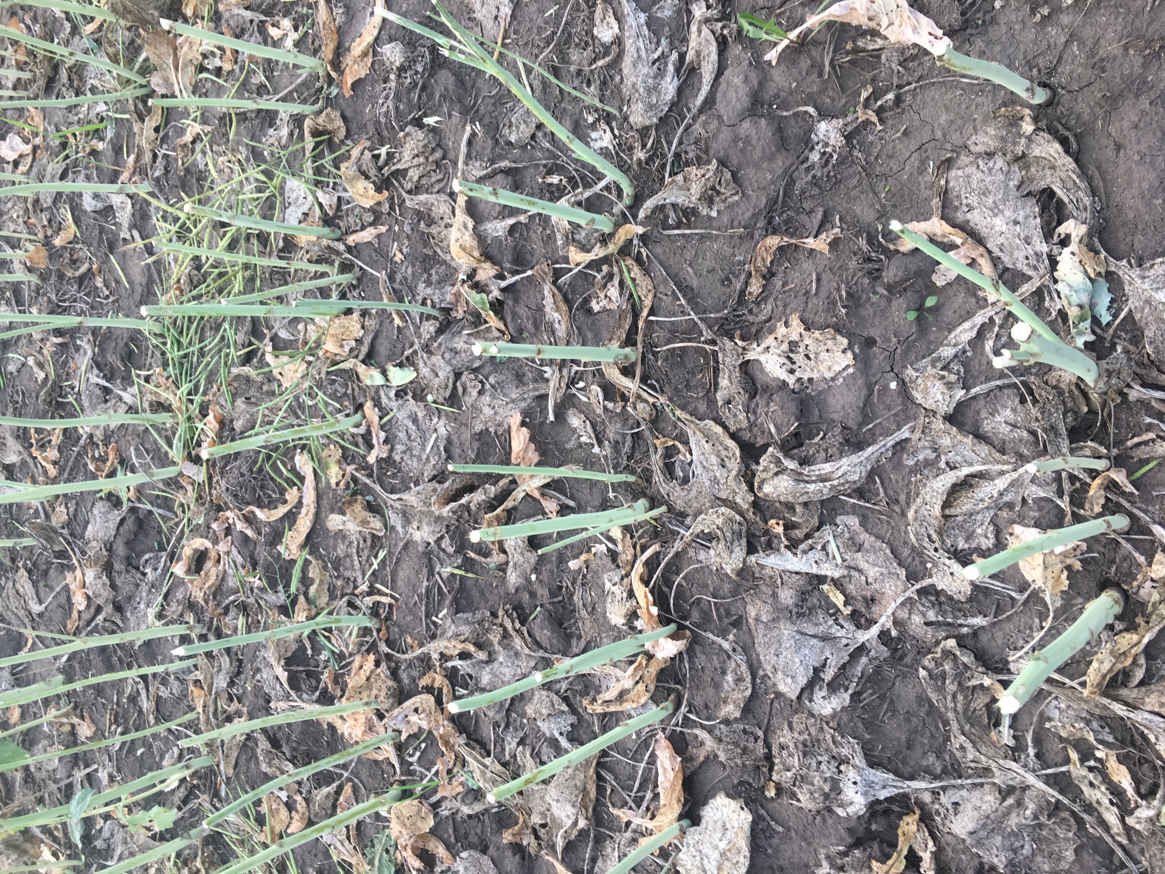

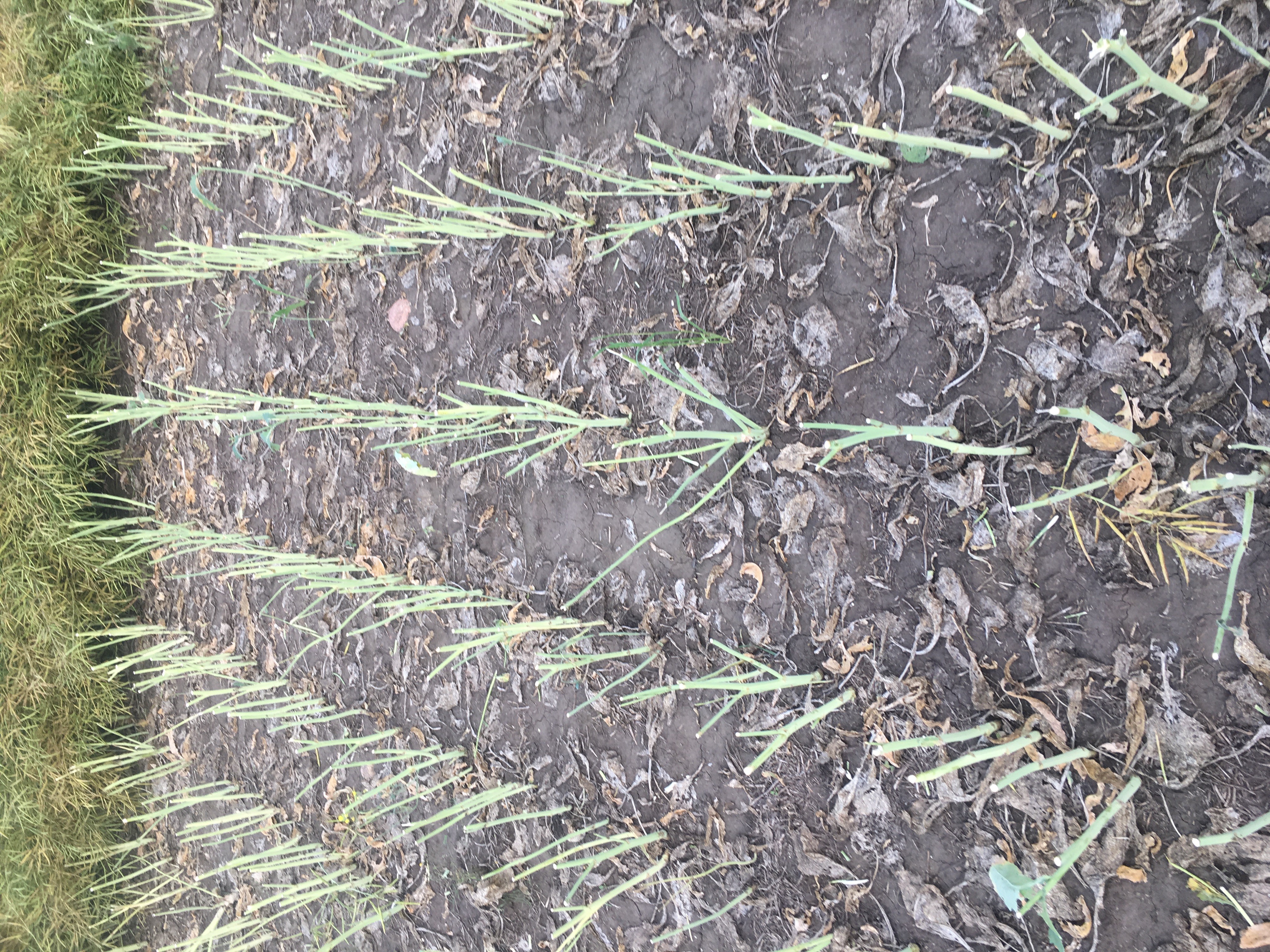

            • 22657
            Stubble side by side with drill at 4.7 lbs
            In all side by sides the canola seeded with planter started 3-4 days ahead , flowered 3-4 days ahead and still the same at swathing

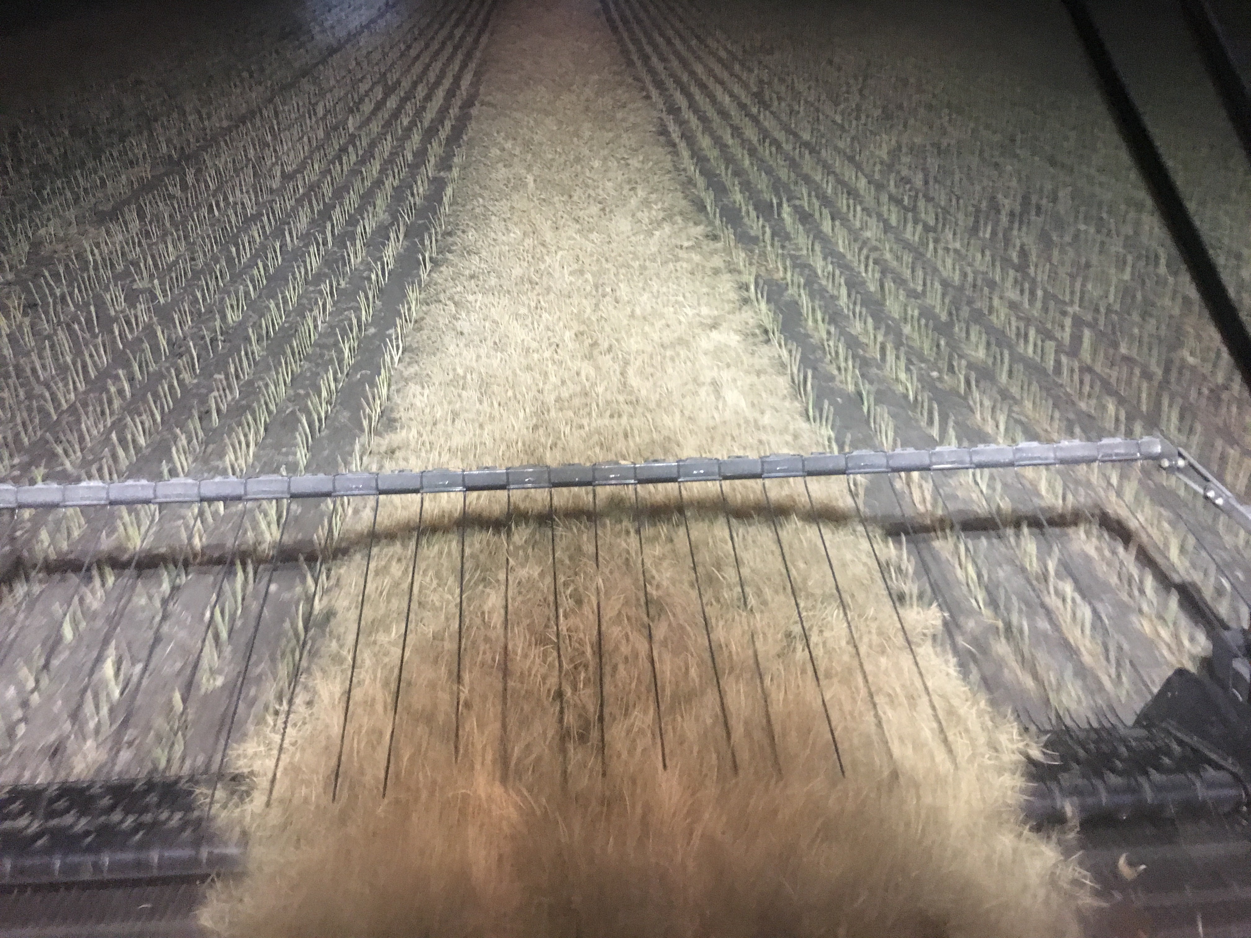

                    • 22657
                    Combining the canola seeded with planter today. ....
                    So far very pleased
