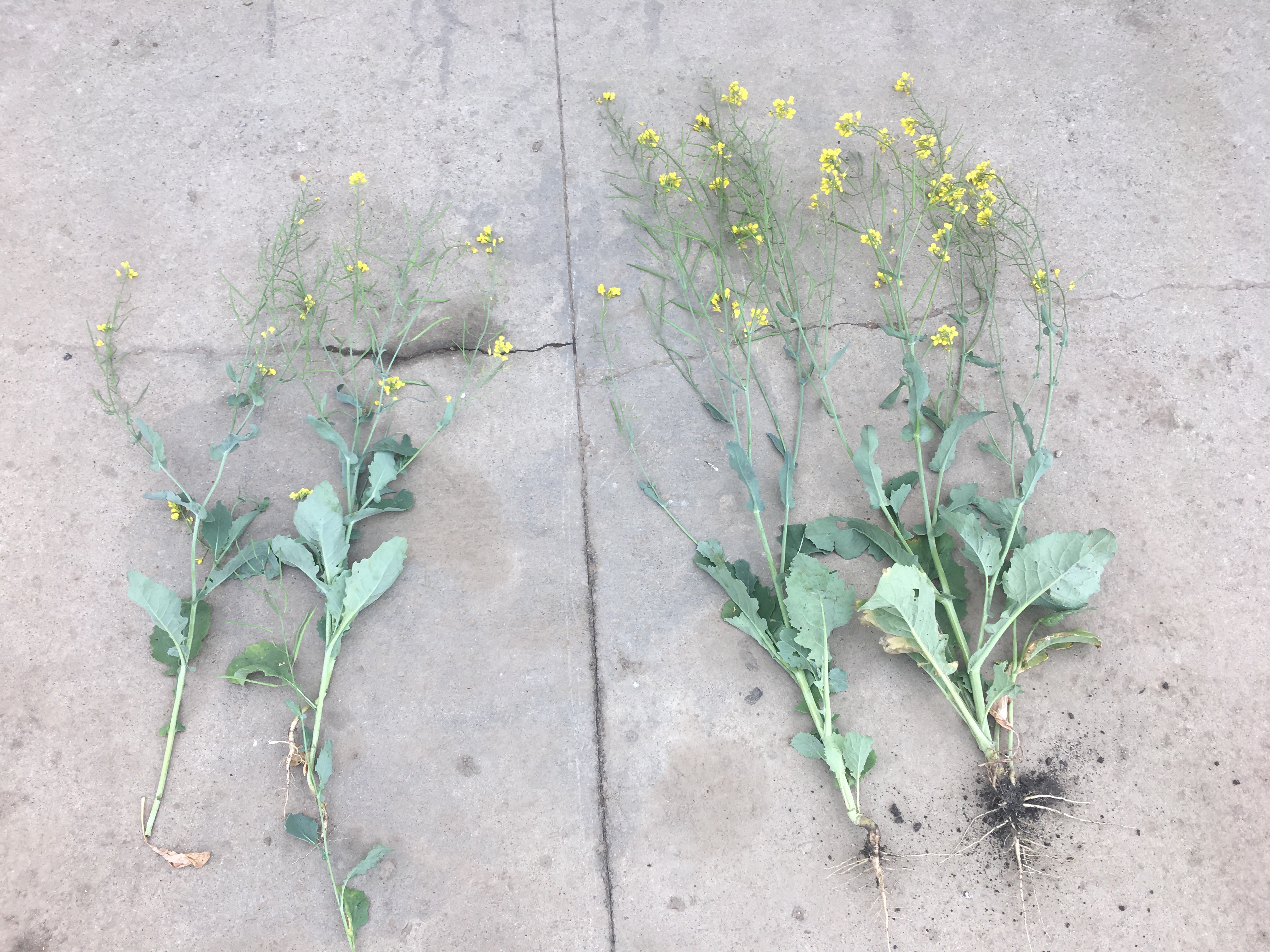

            Pulled some canola plants from the planter at 2 lbs and the drill at 4.7 lbs ....
            Drill on left , planter on right
            Both have a lot of blanks but will know more when full pod
            Still very dry here , totally missed rains 2 days ago
              So did the planter roots break off because they were deeper or what happened to them?
                • 22657
                Cause it's fricken dry as hell man .
                  But seriously, is it coincidence that one lot snapped off and the others didn't? Is the ground drier after the planter versus the drill?
                    • 22657
                    I just grabbed plants from one one side then the other because of the difference I seen .
                    Hmmmmm , the planter canola plants have the whole roots there so wtf are you talking about ?
                    The drill canola plants have roots missing.

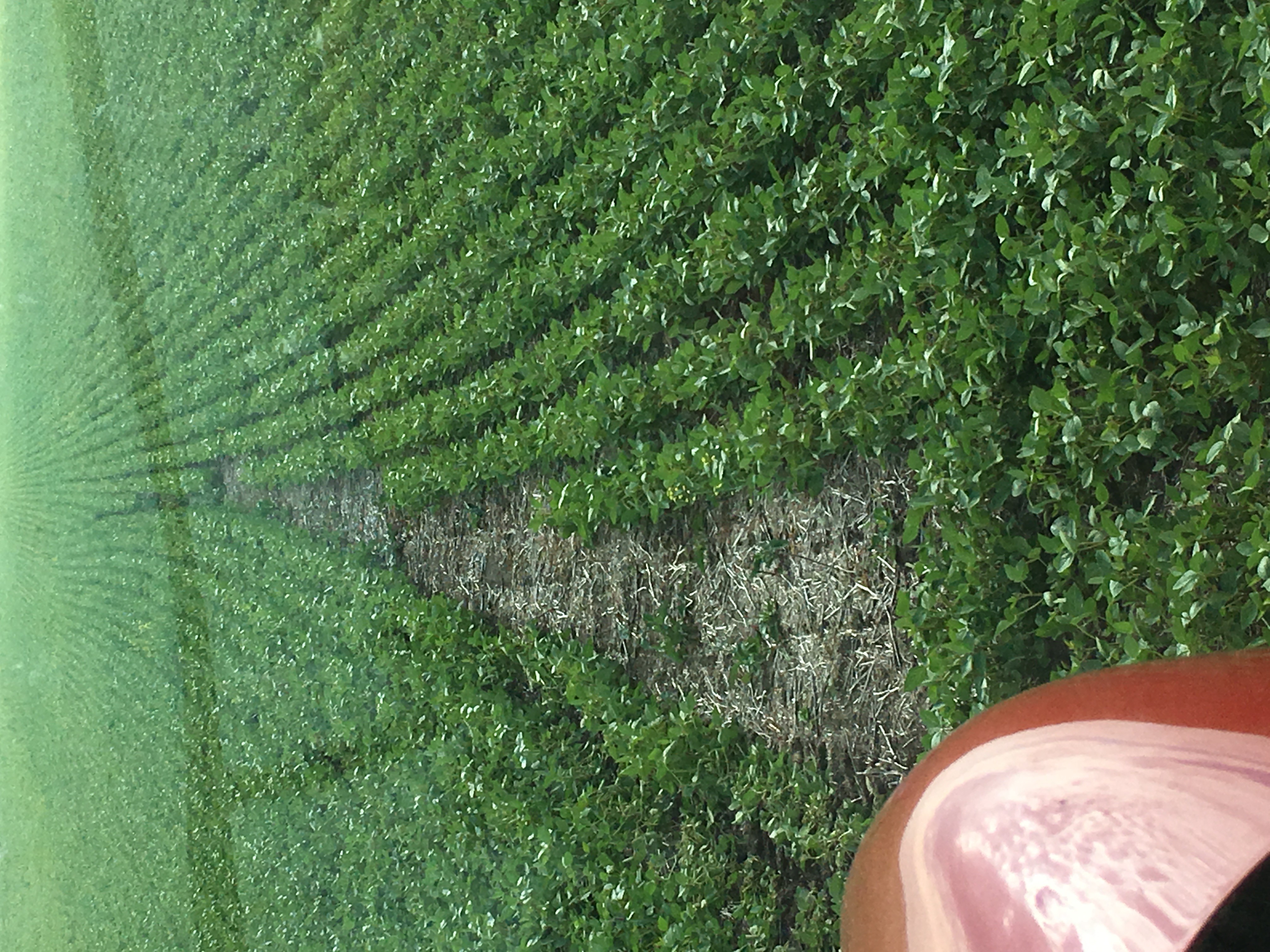

                      Soybeans seeded with Horsch planter on the same 15 in .
                      Just showing the individual row control.
