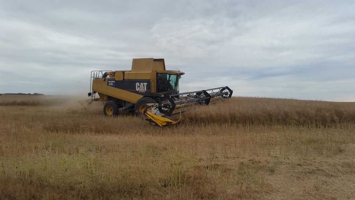

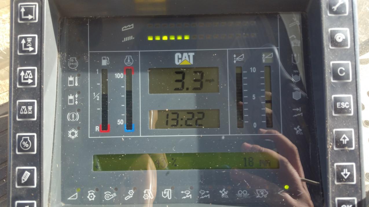

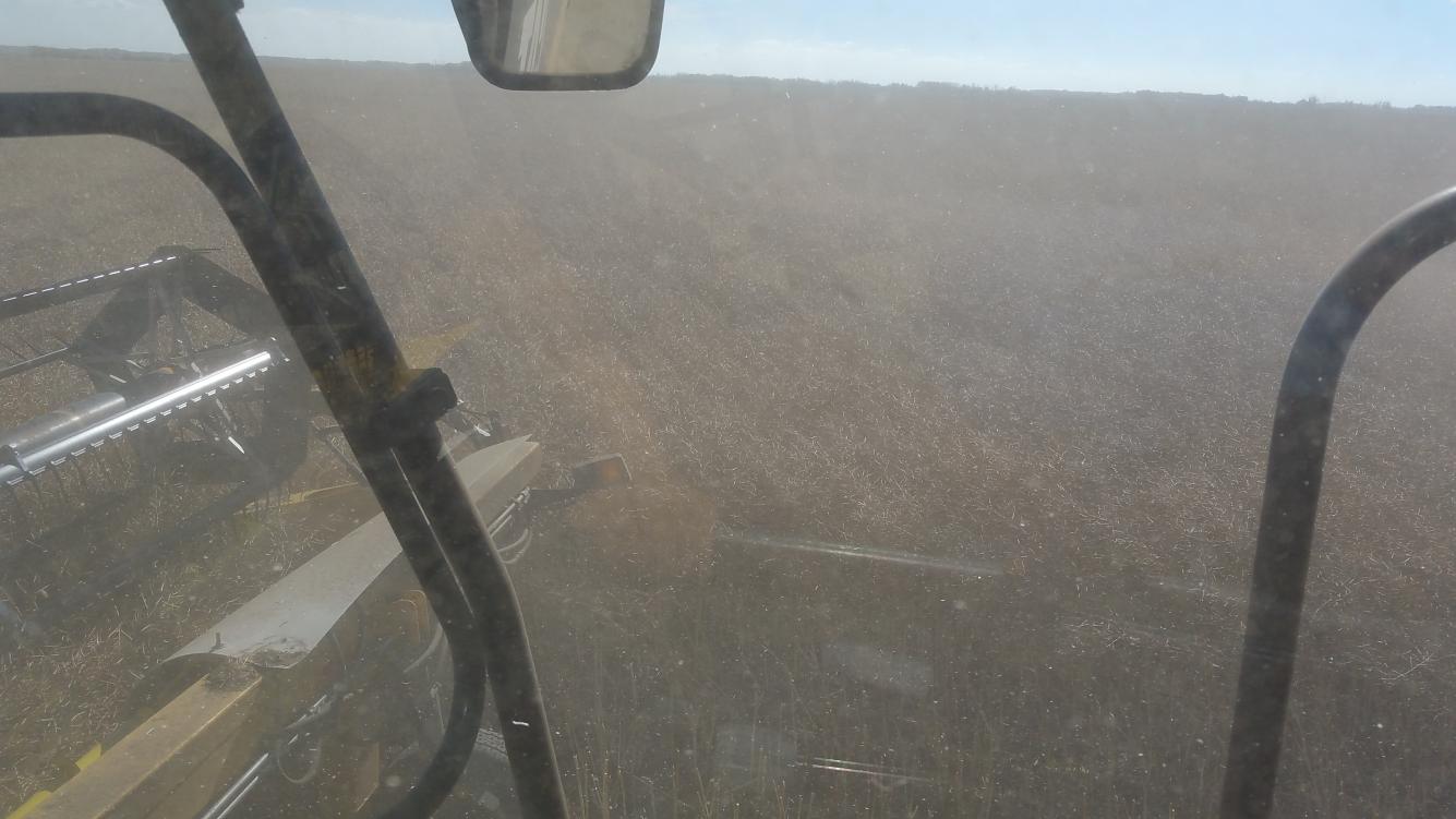

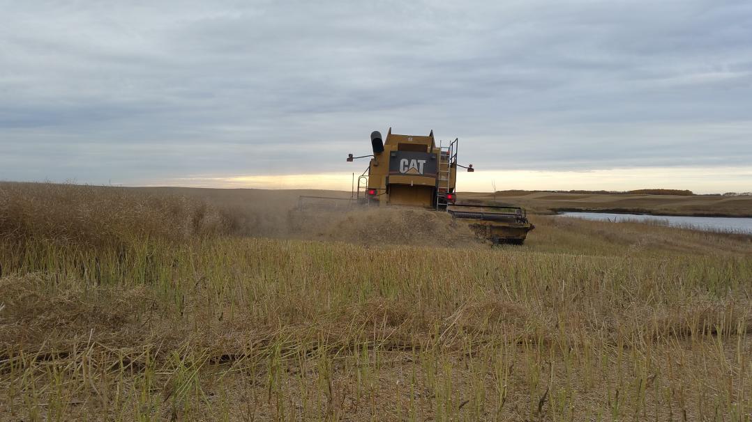

                Wouldn't wanna swath canola anymore. Nope.

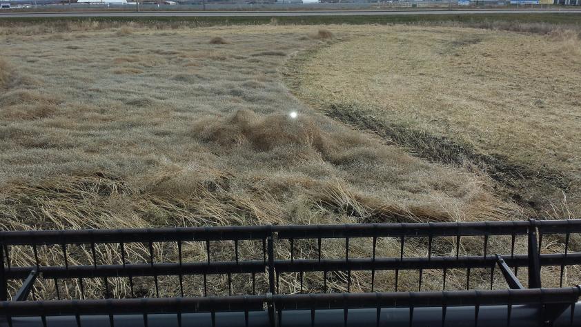

                • crusher
                  • Jun 2001
                  • 1191
                  Straight cut can have a dark side too. But I'M DONE!Click image for larger version
