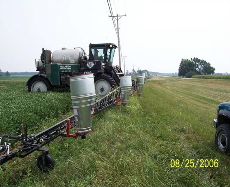

            You could spread radish mid season ...early July if the spreader could follow sprayer tracks.
            They would be in great shape by this time and working hard to sub soil.
            I had limited success with radish in 2015 due to a dry spell but could see the benefit in areas they actually grew.
              Something like this to follow sprayer tracks? This was Kevin Elmy's picture in SK. Herd electric powered spinners.
Name:	sprayer seeder.jpg
              Or get it flown on - they do it in the US over corn.
