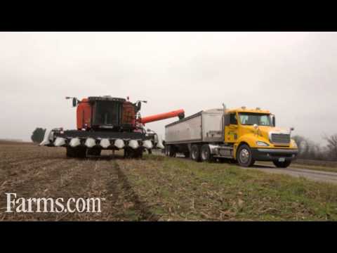

    TRIBINE INVENTOR—Bob Dillon is the inventor of the
    Tribine, a new combine that brings together Class VII
    combine threshing capacity with 1,000 bushels of
    grain storage capacity. The machine has been
    impressive in preliminary tests. (Courtesy photos.)
    UNIQUE PACKAGE—The Tribine's front module is a
    modified Gleaner S77 combine; the rear is a unique
    grain tank manufactured by CrustBuster/Speed King.
    Inventor Bob Dillon refined the machine on a shop near
    Moundridge, Kan.

    The front half--or module--of the Tribine is
    essentially a Gleaner model S77 combine, with the
    grain tank removed and replaced with the combine's
    370 horsepower engine. The only modification to the
    engine is the addition of three hydraulic pumps, used
    to power the machine's all-wheel-drive, four-wheel
    steering cylinders and massive unloading auger.
    What makes the Tribine revolutionary is the rear
    module, designed by Dillon and built to his exacting
    specifications by Crustbuster/Speed King. The rear
    module features 1,000 bushels of grain storage
    capacity, with an unloading auger capable of filling a
    semi truck in two minutes. To accomplish that, "the
    rear module has some cool engineering," says Rhein
    Herrman, an engineer with Crustbuster/SpeedKing.
    The 22-inch diameter unloading auger, located at the
    machine's rear, has 23-foot reach, allowing the Tribine
    to be equipped with a 12-row cornhead or 35-foot
    grain platform. The auger is designed in two pieces;
    the bottom auger is mounted at a less than 45-degree
    angle from horizontal, which improves grain flow
    speed. A sealed joint between the lower and upper
    augers prevents grain loss; meanwhile, the upper
    auger can pivot fore and aft, up and down to enable
    operators to fill an entire semi with a minimum of
    movements.
    "We used a lot of engineering know-how on the auger
    system," Herrman says.
    Clean grain is transferred from the threshing module
    to the rear module via 12-inch auger. Inside the tank,
    the drag auger stretches from one corner of the cart to
    the other, whereas most grain carts use an auger fixed
    to the center. This improves unloading speed and
    capacity.

    Compact machine
    The Tribine is hauled on a trailer custom-built by
    Landoll Corporation, based in Marysville. The trailer's
    top deck has innovative carriers for each of the
    machine's four tires and wheels; the steel frames can
    be moved via forklift and positioned right at the hub,
    so operators can easily bolt onto the hubs.
    At just 35 feet long and less than 15-feet wide, the
    Tribine actually has smaller transport dimensions than
    many Class VII combines.
    The machine's tires are key to the relatively light
    footprint; the special Goodyear radials are four-feet
    wide and six-feet tall. Ground compaction is, "less
    than a Class VIII combine, and far less than a 200
    horsepower tractor pulling a 1,000 bushel grain cart,"
    Dillon says.
