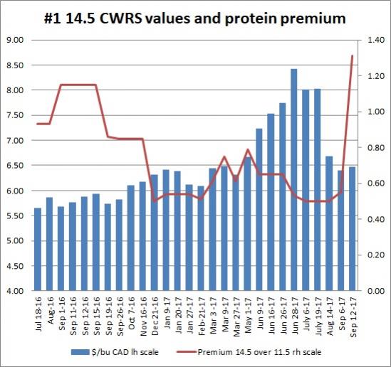

    finished the titanium wheat, px averaged 14.5 on the lot of it , most was 14.5-14.9. yielded fairly well . most px around here is 11 and under. one small field was 13.5 to bring average down . one co around here upped their px premium to $.50 /point . wonder how high it'll go ?

      • 3958
Name:	#1 14.5 price and protein spread Sep 12 17.jpg
      How high? It's headed in the right direction. Good if you have high protein.
      Very bad if you have low protein.
