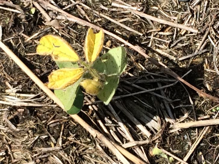

      Iron Deficiency Chlorosis is bad this year. A factor of cool slow growth, and excessive moisture.Click image for larger version

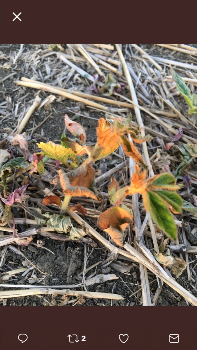

        Anyone's soybeans get damaged from the last frost risk?

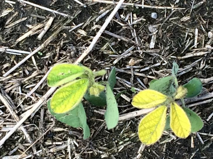

            While stress from cold and rain is a factor, they need iron to produce chlorophyll. It is quite evident by the veins in the leaves being green.
            If it was just cold, and too much moisture the leaves would be all yellow.
            Really a factor of cool, all of a sudden too wet, salt, and calcareous soils which defines much of Manitoba, derived from limestone.
            The beans I pictured were in Saskatchewan, similar conditions, but are starting to come around.
            Another stress on many fields was we recently sprayed them, and they are trying to metabolize the herbicide with the other stresses. Acidifying the root zone to get iron becomes a challenge, and many if not most fields are yellow.
            The green veins identify IDC, and not other stresses.Click image for larger version

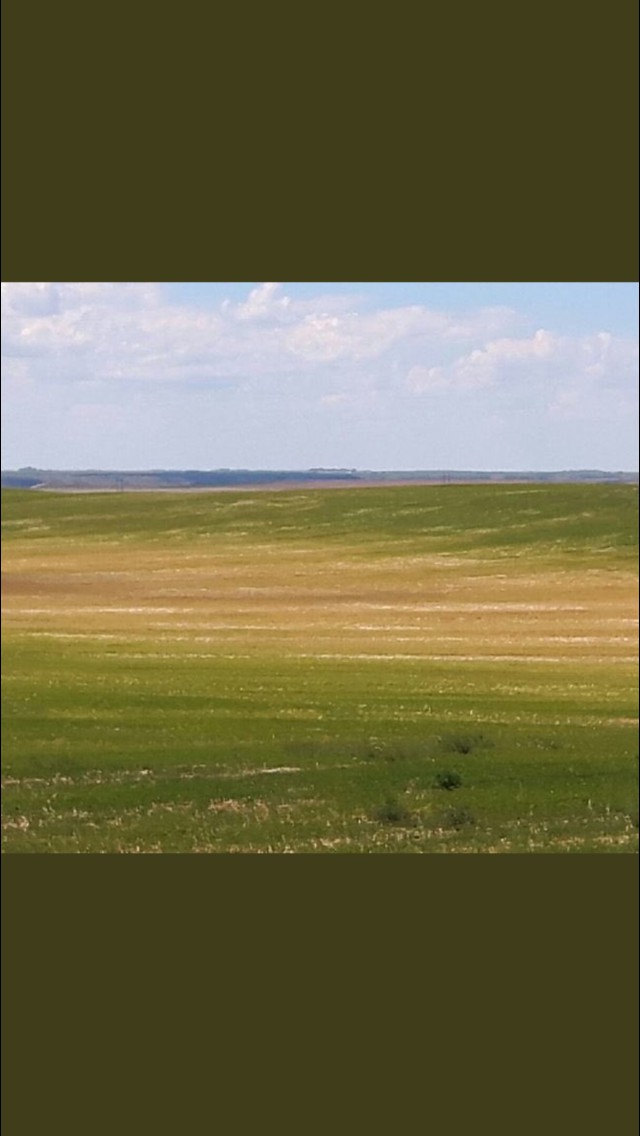

                  Moose Jaw area I was told ...
                    • 22625
                    Lentils - frost , Saturday morning near Coronache ...
