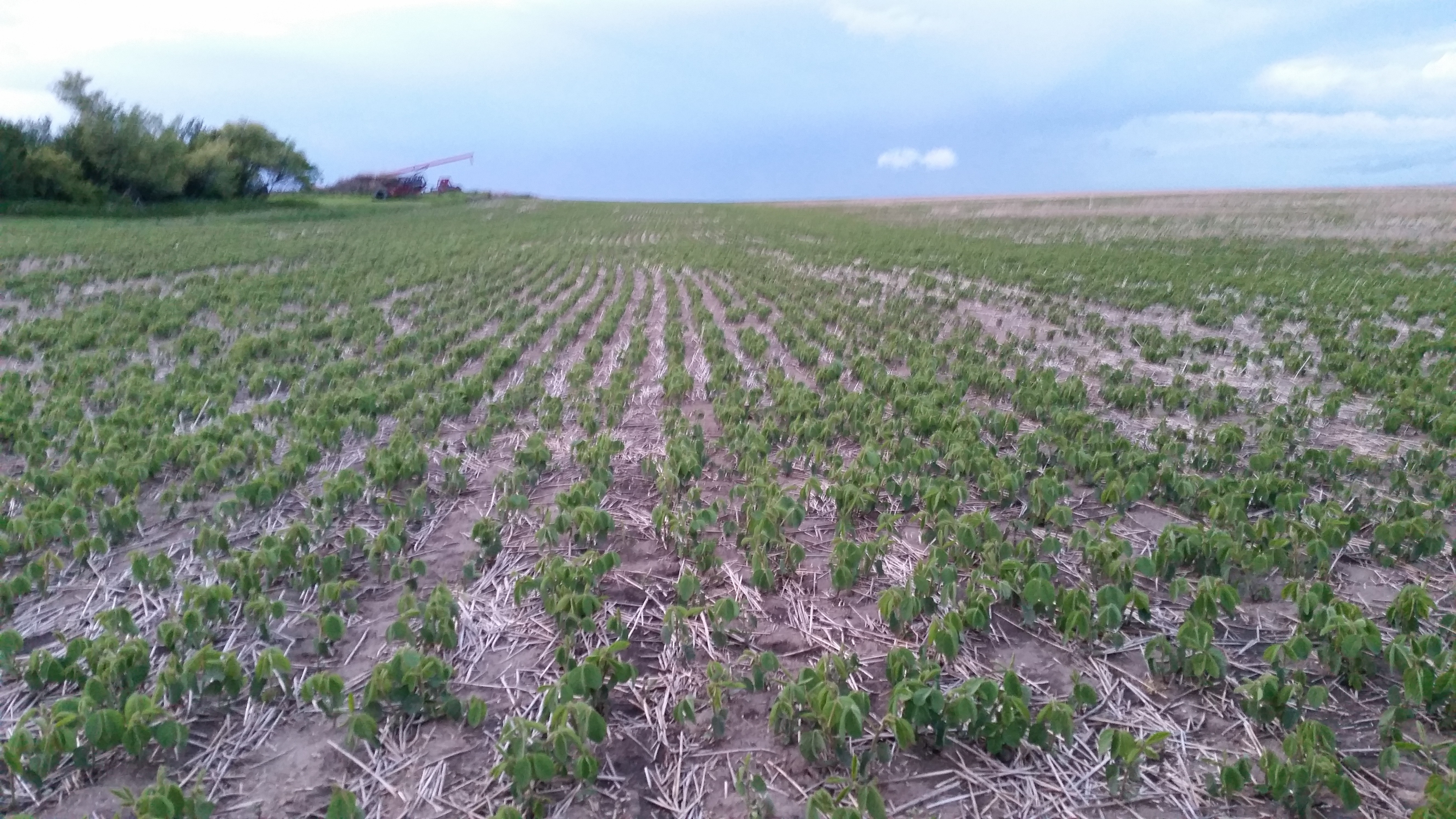

    Experimenting with 80 acres of beans this year. Staging is anywhere from unifoliate to 3rd trifoliate. Vast majority is at the latter stage, but some popped up late for one reason or another.
    What im wondering is will the plants pop back up after spraying, and if so up to what stage will they pop back up? Or is anything trampled simply a loss? I blew a pass of straight glyphosate at ~390g/ac about 10 days ago to burn the wild oats and volunteer wheat out, but Im looking to go a 2nd time with Roundup Xtend. Any advice would be much appreciated.

    Lets try this picture thing again...

      So they are obviously extend beans?!
      Not being smart but have saw some wipeouts like with viper on clear field canola.

        Looks late for spaying Extendimax. Any emerged non Extend beans in the area will be at risk. While not as volatile as old Dicamba, it's still volatile. Recommended to be sprayed premerge burn off.

          Hmm. I was under the assumption the dicamba was for post emergent and or pre emergent control. If i recall, the label said up to 2L/ac pre emerge, and a max of 2L/ac post emerge...
          Regardless of whether it gets the Xtend or not, its going to need something, and the options I have are a pull type sprayer with ~6ft of trample per 95ft, or hire the nieghbor with a high clearance at about 3.5ft of trample per 100ft. If they'll bounce back up, id hit it with mine, if they wont id hire the neighbor.

              Dicamba will work on them post emerge. It's just risky because of the volatization. The US has serious drift issues with Dicamba and non Extend beans.
              On your trampling question, I don't think you have to worry. I only have a few years experience, but everything I've seen says you'll be ok there.

                What weeds are you after? Xtendimax would give about 14 days residual, but at that stage might not be of value.
                If you have an Xtend variety, and weren't told of the options advantages and risks, that is quite irresponsible of the retailer. Monsanto had contractors out this spring to discuss Xtend with any growers that had purchased the technology, and explain the system.
                Label wise your best option now would probably be Viper if you are trying to control volunteer canola, and adding something to your glyphosate is a good management decision.

                  Spray in the afternoon when it is hot. No damage.

                    Group 2+9 resistant kochia, buckwheat, and millet are the largest concerns right now.
