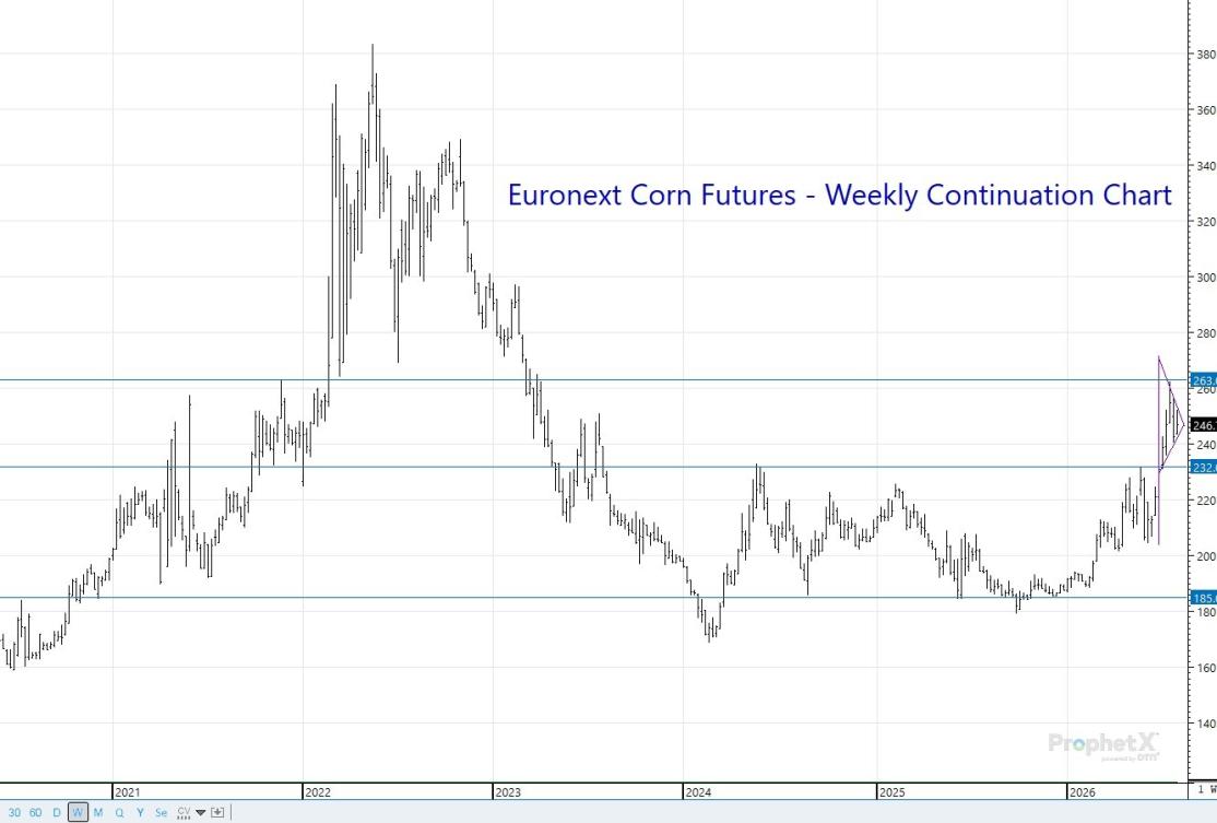

    That takes us to the technical analysis portion based on the accompanying chart. In short, all indications are that the bottom has been left far behind with significant upside potential remaining ahead.
    A saucer bottom formed from February 2025 until the eventual breakout at the start of July (not drawn in on the accompanying chart but easily identifiable). That developed within a sideways channel between 185 and 232 euro/mt that has framed prices for most of the past few years. A breakup from the channel has a measured move equal in size to the old channel range, leaving an objective of 279 euro/mt. For the saucer, the longer it takes to form, the higher the target -- with this one coming in at around 360 euro/mt for a measured move. In addition, a bull pennant is being formed by the consolidation currently seen following the test of resistance at 263 euros in mid-July. The measured move for the pennant would be roughly 308 euro/mt. And finally worth noting, a breakaway gap was left on June 22 at 214.50 euro/mt, marking the beginning of the significant rally seen since.
    There is obviously no certainty that any of the targets will be met, but the clear indication is that the technical analysis portion supports the bullish fundamental clues.
    Finally, it's worth noting that the rally in European corn has not been insignificant, even if it has been largely ignored so far in Chicago. From the June low to the July high, European corn rallied almost 60 euro/mt. That is equivalent to $1.75 USD/bushel or $2.45 CAD/bushel, suggesting a very good reason for importers to look to North America to fill the void left by the drought.

    For the following chart...
    European corn production estimates are declining with every update due to the prolonged drought while import estimates are increasing in step, suggesting multiple bullish formations on this weekly corn continuation chart need to be on the radar. (DTN ProphetX chart)
