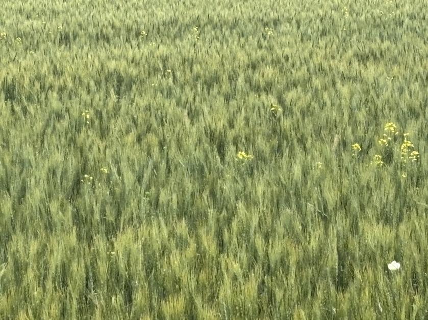

    One thing that came to me from day one was what if you get a late flush in your cereal crops , how does one manage pre harvest ? Swather ?
    We currently have a situation that shows the potential problem , although it’s clearfield canola from last year so not concerned at all
    That late hail storm last year shelled out 20-40 bushels on the ground . We got a flush last fall , then ran the coulter harrow to bust up pods on ground
    Got a good kill this spring but got a late flush again after herbicide. It’s not terrible but will cause harvest issues in the wheat if it can’t be dried down
    Just curious what the plan is for dual trait canola if a scenario happens next year like that ?
    Reglone not registered
    I guess a high rate of Heat ?
