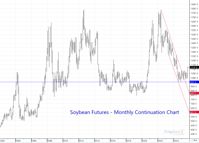

    A key reversal on a chart is rare. A key reversal on a monthly continuation chart is far more so -- and definitely worth taking seriously. In this case, soybean prices opened October on a sour note, gapping below the September low that prices nearly closed the month out at.
    Then the combination of concerns over yield potential declining amid drought and disease pressure and optimism over a trade deal with China resulted in a rally that not only took out the September high but also ended with the October close being virtually on the high for the month, at levels not seen in more than a year.
    That type of technical action will gather far more interest and respect from traders than any fundamental debate, likely along with additional buying support.
    As you can see on the accompanying chart, the down channel that had dominated the soybean market since the top in 2022 had finally been broken out of in April 2024. But escalating trade tensions between the United States and China took the wind out of the sails and pessimism about export potential resulted in multiple tests of support around $10/bushel. Estimates (including those from USDA) were for record-setting yields with added selling pressure the result. Then the positive turn of events in October resulted in support holding and a breakout of a 13-month consolidation range between $9.50 and $10.80 being seen (with prices currently over $11.20/bushel).

    For the following chart...
    The key reversal left on the monthly soybean continuation chart is a strong sign that further gains should be on the horizon, especially when backed by confirming signals on shorter-term charts and improvements in fundamentals recently. (DTN ProphetX chart)​
