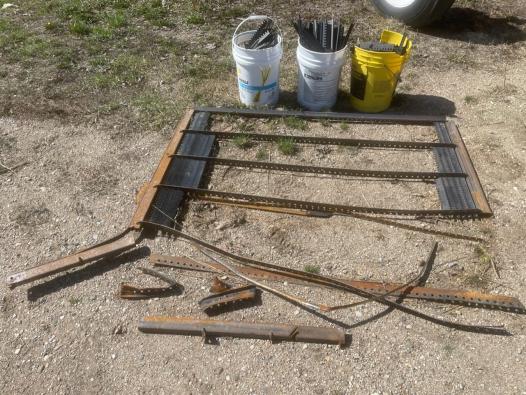

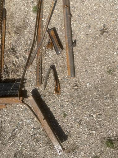

        We had a sieve come apart two years ago in a case combine.Replaced with a Harvest and really like it, will do other two combines when the time comes.Much lighter and cheaper.
        • SmallTimeOperator
          • Mar 2021
          • 229
          Only sieve I ever had that allowed you to put pods in the tank and seed out the back, so for that they have everyone beat. Louvres are actually so easy to change they come off by themselves! And it was so much fun spending 2 days trying to get louvres out of the elevator and getting the steel pieces cut out of the cross auger and the bubble up auger. Oh, and unloading my semi with my air seeder screens to remove debris was such a great idea I’m surprised I never thought of that before! And the genius who put them in my combine even disconnected the cab adjust linkage and threw it away so you had to manually adjust them! Why didn’t I think of that! An extra 15 minutes to breathe in dust every time you want to try a different sieve setting. And he even custom made a nut with a little point on it to hold the sieve in position as the adjuster! Worked great in all crops, always had lots of empty whitecaps in wheat and lots of empty pods in canola.
