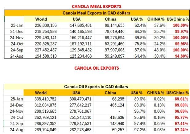

      Correct me if im reading the data wrong..
      I have no idea where you're getting that data. 50,000 MT of canola oil is 2 vessels (120,000 MT of raw canola) - not quite a year's supply I'm afraid.
              What are you doing Larry, you know the data better than that. According to the Canadian International Merchandise Trade data issued by Statistics Canada,
              China was shipped 393,046 mt of canola seed in Jan. 25 vs 104,890 mt in Dec. 24. Almost 4 times the previous month - a return to the market without question.
              China was also shipped 50,472 mt of crude canola oil in Jan.25.
              That compared to 665 kg in all of 2024 -- 121,787 mt in all of 2023 -- and 185,109 mt in all of 2022.
              In the time from Feb. 1 until the tariffs were announced, China could have already been shipped nearly the same as all of 2023 (a years worth) and a huge rebound from 2024.
              I have no idea why you would confuse the data with your chart on Canadian Dollar values of obviously REFINED canola oil (1514.19) instead of CRUDE (1514.11) canola oil to discredit a proper post. Seems like something a troll would do.

                      I did that refined oil/meal chart on Sunday, March 02 for a crusher who has assets on both sides of the border that wanted it in dollars with meal and refined oil for US and China because that's what they asked for - on a Sunday no less. I put it in with the meal first. When you figure out why they wanted refined oil and not crude, please email me.
                      Both of you think that 50k of oil is substantial when it equates to 120,000 MT out of 3 MMT of seed already shipped to China in 6 months - a paltry 4%.
                      Nah, Mitch, if I was trolling, I would have called myself Tech Analyst 2 and said:
                      It is not about the oil, stupid, it's the meal.?
