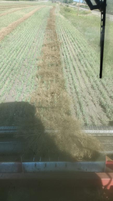

    Started some very heat blasted canola weds that was swathed 10 days earlier. Got busy doing other stuff and finished the field last night and emptied the trailer into a hopper bin today.
    It went 17 bu/acre, 1% green, moisture tests ranged from 5.5 to 8.5 at the elevator while harvesting. There are quite a few sprouts from heat stress/hormones and the front hopper (worst part of the field for heat blast) was heating. Hot to the touch and stunk.
    Lucky it yielded so poor the field fit on one super b load? I have air in the bin but dont have enough canola to cover the rocket duct. I don't have more canola ready to top up the bin and hesitate to make it worse.
    I have a recirculating batch dryer I can run it through without heat and try to air dry it while blending the crap out if it?
    I didn't get a seperate sample of the heated hopper but the whole load was 9.8% moisture (I did 3 tests while combining and the highest was 8.5. Did it pick up moisture from sprouting?)
    Anybody have experience with this stuff? Should I throw heat at it and take it down to 5% so I can sleep at night?

      I popped a few pods open on standing canola the other day and there were a couple sprouted seeds in it and the rest were shriveled pepper already. Not sure what best thing to do with it, try and get it cooled down maybe run through your batch dryer on a cooler night.
