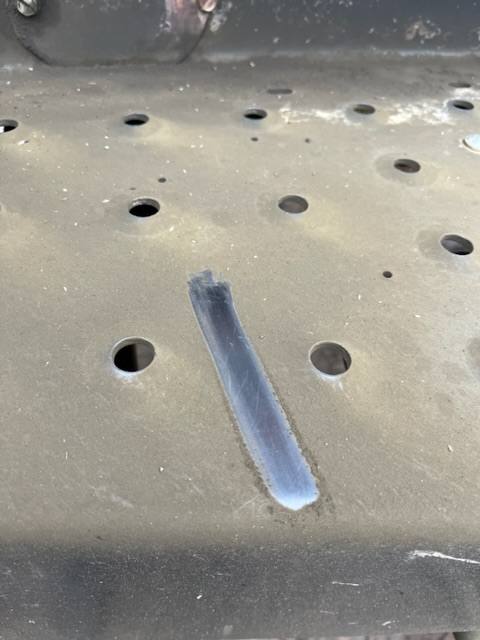

    I know it’s not cool to swath canola anymore but I am anyway. I’ve never seen this black dust all over the swather like I’m seeing this fall. Anyone know what’s up with that ?

    Could be alt black spot . Seen it before at late staging . Can cover swather with that black / dark rusty dust . It can explode in certain conditions like this past few weeks in areas

      I hit like cause I like that you replied not that I like the answer. 🤣
      It certainly seems to have exploded here. Have never seen it like this before.

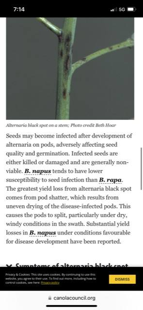

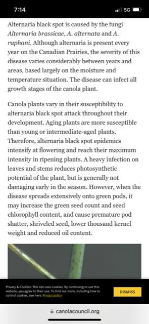

            From the Canola council website .
            One thing of note , watch “straight cut” varieties if you’re in areas under these conditions.
            And most areas in western Canada are now under these conditions after this past week . Especially the main canola growing areas with 99% of the canola still out in field .

                Interesting info on the black spot symptoms. When splitting pods I did notice that many pods would split far easier than normal. Hopefully we can get this swathed canola combined before the wind shells it all out in the swath. It is a Dekalb variety with “pod shatter resistance” bred into it. Definitely the riper patches that have the dark/ dirty look to them.
