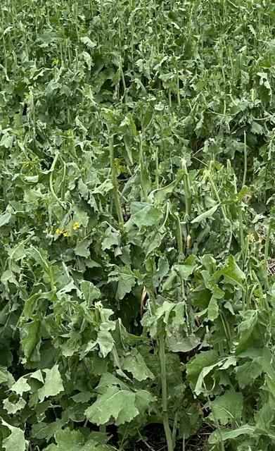

    • 22655
    We have left this yet for a few more days
    Probably won’t make it
    Other stuff like this …
    We have sprayed a fungicide, 2 litres of alpine and 1/2 litre micro bolt boron a few days ago
    It’s recovering decent already

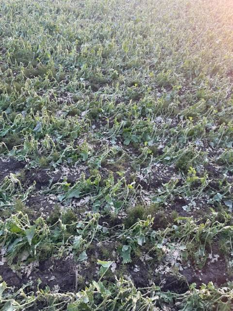

          Had canola look like the second picture last year. Ended up yielding as good as anything we had and never sprayed it.
            • 22655
            On long open falls that can happen for sure
            We have seen several times a gain of maturity of up to a week with a bit of Alpine . But we are in a frost prone area so we try what we can to push maturity in situations like this

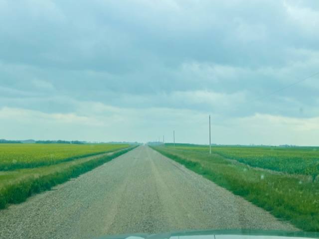

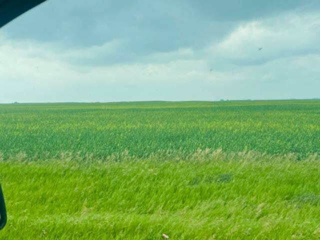

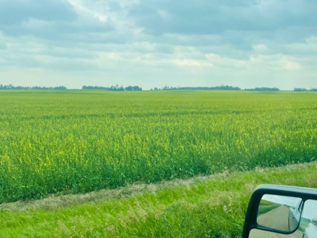

              Went for drive to see some canola we sprayed with Viatude and some foliar last Thursday
              Was much like this
              Canola across road to the right was hit the same , but no foliar .
              Both recovering decent
