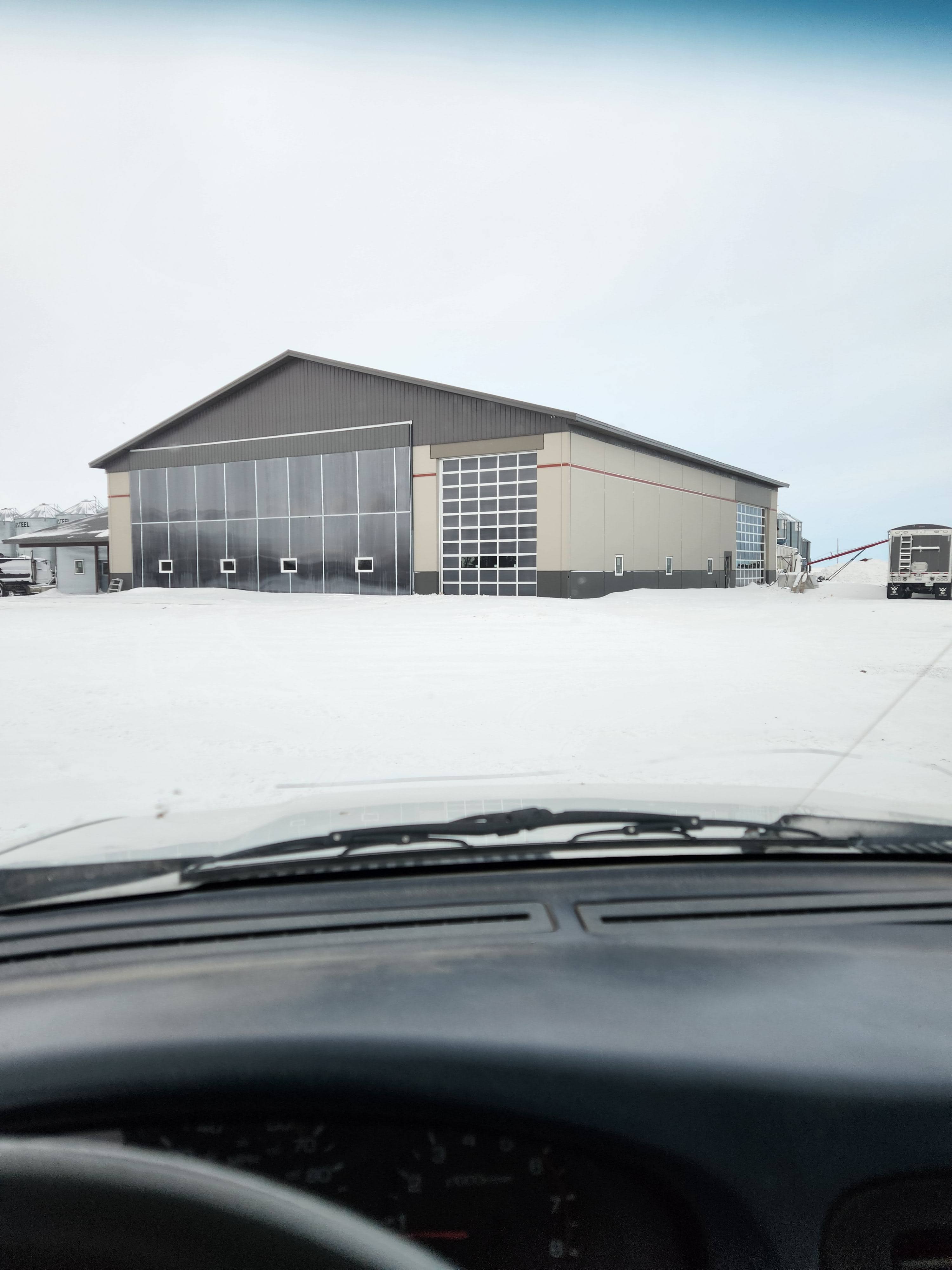

                  This is the concrete building with wood roof
                    Do I dare ask the price of a concrete building?
