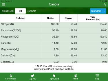

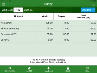

            The chart for barley and canola shows the nutrients required to grow a crop, but not how many nutrients might get tied up.
            In 2021 it seemed like the initial spring moisture was good enough to tie up the N in the previous years wheat straw, but there was not enough moisture to decompose it and release the N back.
