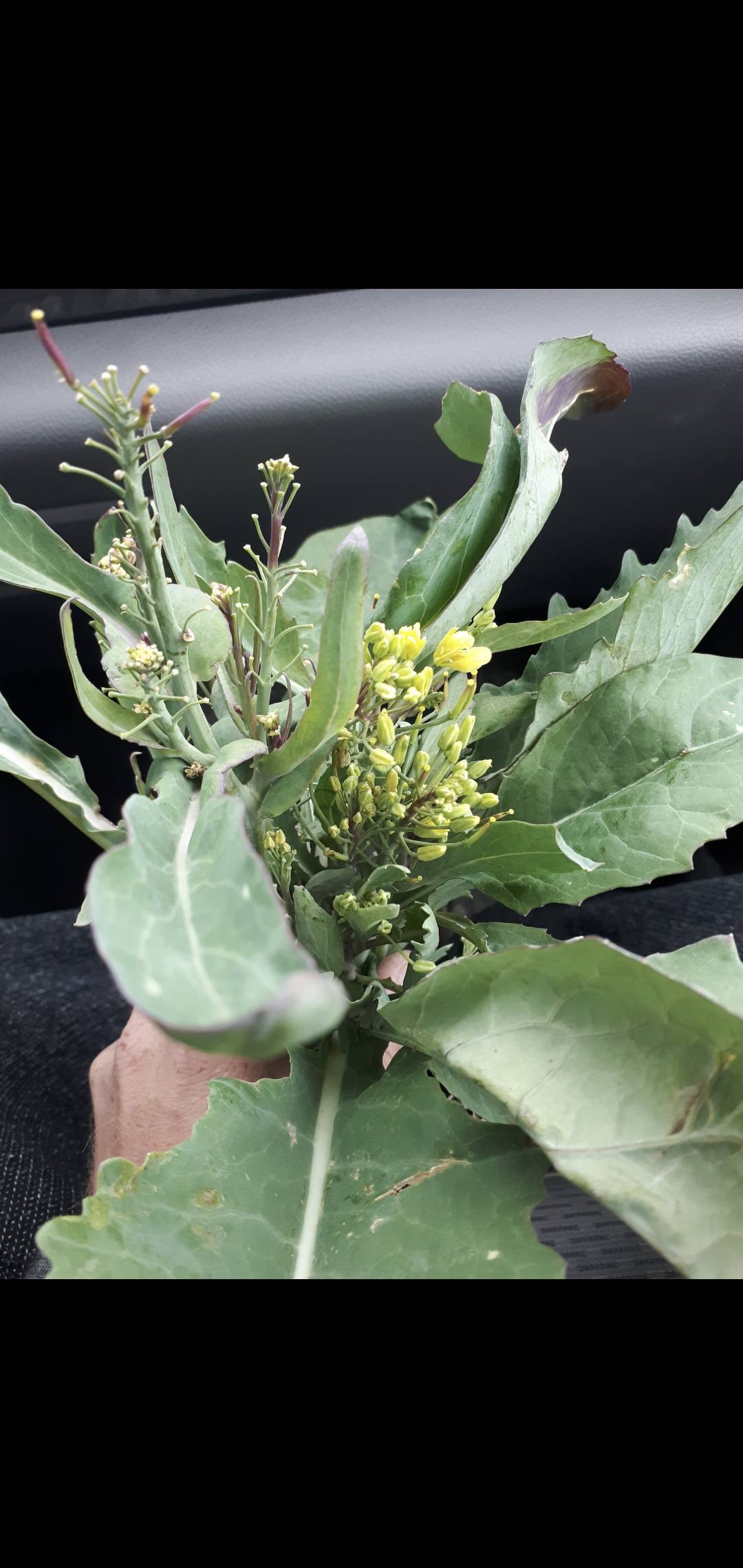

    I assumed we had escaped the invigor problems this year. It all came out of the ground and never slowed down, cabbaged looked good until bolting. Then, instead of making flowers and pods, the previously wetish areas turned into deformed purple bushy plants with no pods, and aborted/white flowers.

    Invigor did the opposite. Once it finally warmed up and quit raining, the Invigors gave up. Plants were bolting even through the wet areas and looking very promising. But the flowers/pods aborted. The plants turned purple. They grew really bushy, loads of thin branches, mostly with no pods. Lots of biomass, but almost no viable seeds. They kept flowering very late, but still made no pods. Many areas eventually came back were and outgrew the purple deformed plants and were lush, green and full of flowers in early October while combining ripe crop right beside. But still no pods.

    There were also some isolated patches of high dry land, where later on, the plants turned purple, really tall, really bushy and deformed with no pods. In one case it happened all along the roads. Not sure if this is the same issue or unrelated
    L343. L345, and L234. With L345 side by side with both other varieties in 3 much different locations.
    Seemed to be most prominent in the L345, least in the L234. Also had one strip of pioneer LL, side by side, and there was a literal line where the purple plants started where I changed back to the Invigor.
    Has anyone else seen this, this year or other years? Or had any other variety do this? This was the first time I grew the L345 or L343. Was very happy with the L340 last year with no rain, but of course it was cancelled and exchanged with L343 after I pre ordered it last fall.
    BASF insists it is unrelated to the seed/seed treatment issues. I would rather they told me it was the seed/treatment, even if they won't compensate, so I could be condident that this was a one off, and be confident in using invigor again next year. Because if this is environmental ( hormones due to the stress as I am told), and if it is unique to Invigor, then I'm not sure I can afford to have this happen again.

          The way you describe the field sounds similar to what we used to see here with severe sulfer deficiency.
          What do you use for sulfer product?

              It definitely looks like sulfur deficiency. But virtually every other stress to a canola plant exhibits the same purple symptoms.
              I had a small patch last year that really was sulfur deficiency. Virgin canola ground so it probably has rarely if ever had sulfur applied. I didn't empty the last of the cereal blend out of the drill. And on the strip where the cereal blend with very little sulfur where it finally came out, the plants were spindly and purple and yielded very poorly.
              I use 21, off the top of my head, I believe it worked out to 6:1 or 7:1 N to S ratio in the blend.
              But with all the rain we had this year leaching is certainly a possibility. I did top dress some n and S on one hilltop which looked very sickly after all the rain and it responded very very positively. But for the most part, our poorly drained ground is not noted for leaching. If the water was capable of soaking in, it wouldn't be drowned out in the first place.
              And I would assume it would be equally as bad in the pioneer Liberty variety and in the Roundup ready variety. Or is the invigor more sensitive to S levels, or less efficient at scavenging for it?

                  2018 when it was crazy dry Flucarbazone-Sodium gr2 residual?
                  That would be Everest, Correct? I don't know the history of two quarters which I just acquired this year, but they were wheat last year, so that is a possibility. The remaining invigor acres are land I have owned for five or more years, and have never been sprayed with everest.
                  The quarter which had the deformed purple plants along the road edges I assume is some type of residual herbicide from brush control in the ditches. It did the same thing in 2018 in invigor canola. But neither the county nor the power companies have any records of spraying being done there.

                    Group 2 herbicide residual accumulate at the growing point.
                    You have a short plant that basicly stops growing and just sits there.
