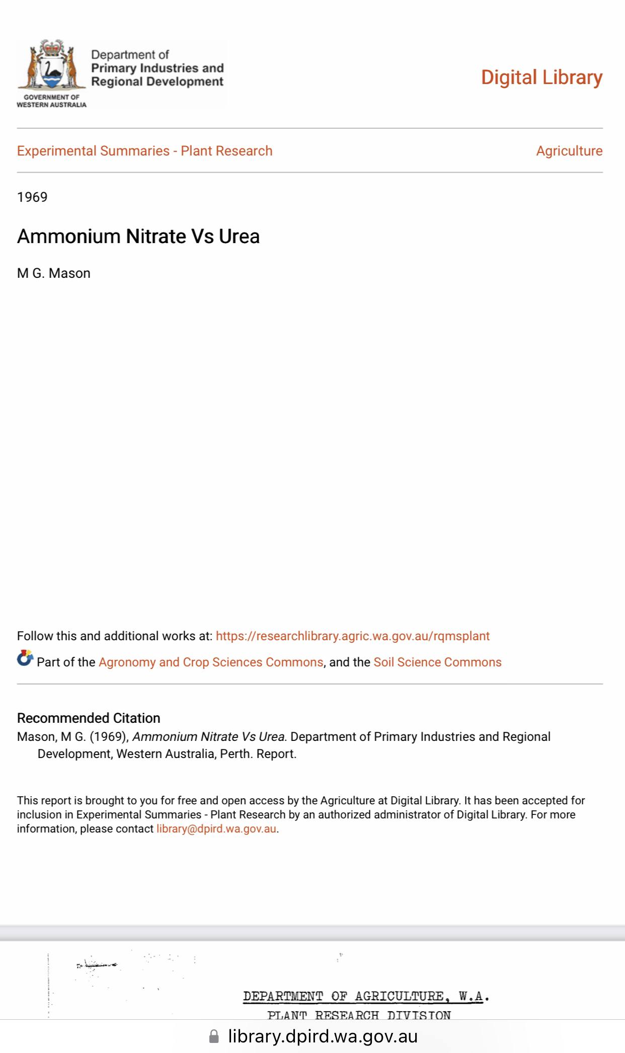

          NH3 vs Urea
          Urea toxicity is well known… NH3 is little different, the release of the nitrogen is slower, because the N concentration is higher with NH3
          Anhydrous ammonia applied to the soil initially has
          an alkaline effect around the point of application~ However the ammonia nitrogen is gradually oxidised through the nitrification
          ion process and therefore the final result iN an increase in acidity in the soil. The degree of acidity per unit of nitrogen applied is similar to urea or ammoniUJfi nitrate9 i.e.
          about 36 ow·t. Ca Co. per m1it otC nitrogen. Sulphate of ammonia. is much more acid forming - 107 cwt. Caco3 per unit of nitrogen.
          .Ammonia can attach itsalf to the clay particles in wet or dry soils~ In a wet soil the ammonia dis~olves in the soil mois'ture 9 as it is ·very soluble 9 and forms NR40H. The ammonium ions having a positive charge take theirlplace on exchange s:j.i:es of the clay particles perhaps displacing bases
          such as ca++ Mg++ or K+. When the ammonia is $.applied in 9
          dry so].1 it ca:n combine with a hydrogen ion on an! exchange site and thus result in exchangeable ammonium ions. ~oil organic matter also provides exchange sites to retain theIammonia. However9 some ammonia can also be fixed in an unavailable form by the orgar:dc matter.
          Anhydrous ammonia is applied in a very narrow band. This means that the concentration of ammonia around the point of application is very highof Free ammonia is toxic to organisms so that this application of ammonia usually~sterilises a band around the point of applicationo This means that there are no nitrifying bacteria present in this zone to change the ammonium nitrogen into nitrite nigrogen and subsequently to nitrate. This limits leaching for a time. Gradually these bacteria carry on nitrification around the perimeter of this zone and gradually work their way into the centre to finally recolonise the whole zone.”
