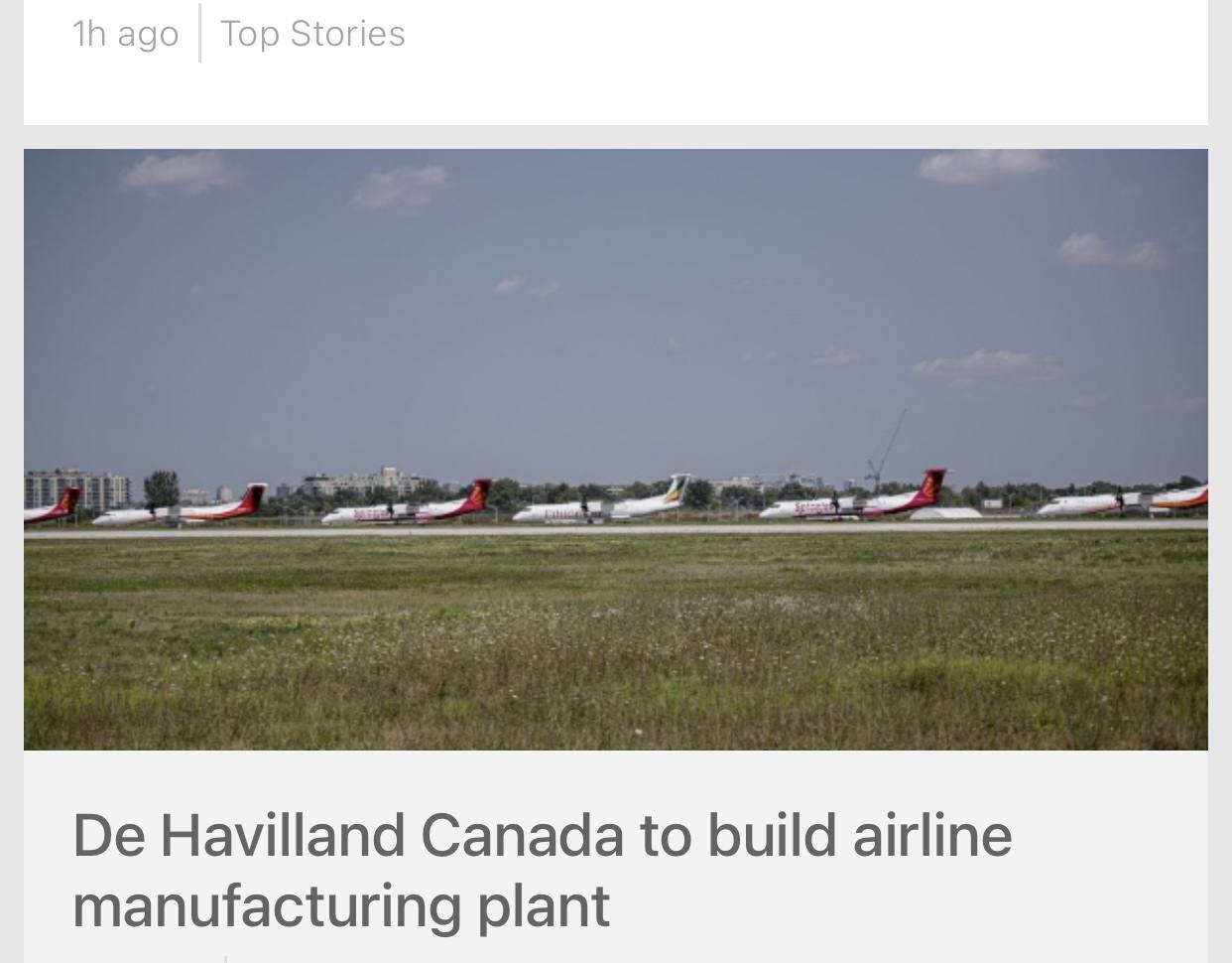

      Like electric aircraft… did you see this?
      East of Calgary a 600ha plant site to build Dash 8 and twin otters… no doubt electric propulsion will be integrated into DeHavillands next generation aircraft…
      A world of interesting Paradoxical solutions…
