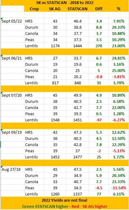

                [ATTACH]11032[/ATTACH
                In 2022 STATSCAN is Satellite based - Ag Can used 37.7 bpa for SK.
                Crop reporters say 34 bpa - Take away the drought year - crop reporters under estimate 7.7 bpa
                I eat live breathe this sh it every day. Farmers only get 50% of the information they need.
                Buyers know what acres are seeded because of sales/input sales and returns and they talk to each other.
                If any one is using the original seeded acres from STATCAN farm phone calls in March - they need their head read.
                If you plugged in 41.7 into the SK production estimates and the real seeded acres; like traders are doing - you would sh it at the number.
                For the record Furrow, I've counted kernels on wheat heads from a Satellite picture that orbits at 705 km; but no one uses that tech yet ...and i say yet...because it is coming. Today's model is vegetative health based on a program that has data back to 1987.
                How many farmers in your area under 37.7 bpa canola and how many over?
                30 and 50 is a 40 bpa average.
                I don't want to fight - take the emotion out of the equation and look at the spreadsheet i just posted...Take away the drought year and this will be the lowest canola bpa posted in 4 years... STATSCAN never called it a bumper... in fact i don't think anyone did. Not even the fat lawyer child...
